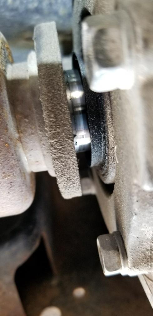

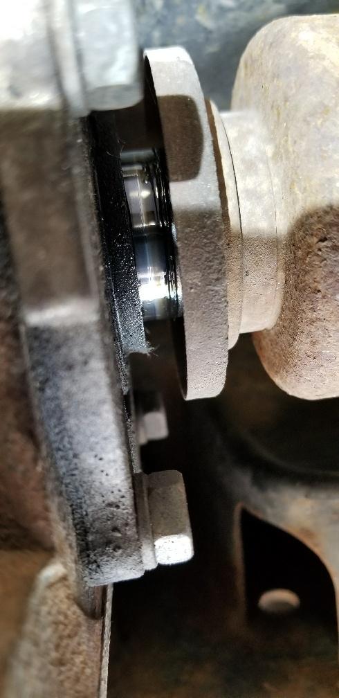

It sounds like a clunk with a buck and jerk...Think I may be on the path to a solution for the "clunking"...backed the Subie up on the ramps to check the CV joints....all boots are intact (couple of them are showing their age but holding still) and the front axles seem quite solid...now the back...that's a different story...I snapped a couple of pic of the rear axles where they meet the rear diff (sorry cannot figure how to place the pics in the post) I am getting a ton of play in and out of the differential...looks like almost 1/4" of play in and out of the differential (guestimating as I had nothing to accurately measure with on me)...is this in anyways normal? What retains the axle into the differential?

I'm no expert but, I suspect that's normal - looks dry and if there was a severe issue there, I'd bet fluid would be leaking past the seals. (NOTE: might be a good idea to check the fluid level back there - or just do a fluid change)
they are retained by C-clips like front stubs/axles IIRC. you could dig around at www.opposedforces.com for a diagram.
sometimes, bad u-joints can mimic torque bind - probably have to disconnect the shaft to really test them but, the symptom seems more like the center diff has gone bad. One more test. Arrange to drive the car in tight circles on dry pavement when it is STONE COLD. Not even 5 minutes of driving OK? If it doesn't buck when cold, but does after 5-10 minutes of driving, 95% that the center diff is bad in the trans. Have read of this several times in the past.
