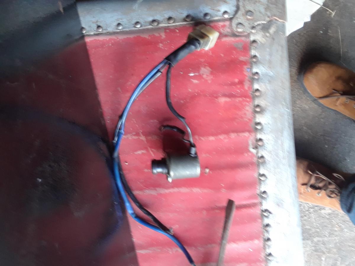

February 20, 20188 yr Author <a href="http://s50.photobucket.com/user/Michael_Allman/media/20180220_171935_zpszvziqfuz.jpg.html" target="_blank"><img src="http://i50.photobucket.com/albums/f338/Michael_Allman/20180220_171935_zpszvziqfuz.jpg" border="0" alt=" photo 20180220_171935_zpszvziqfuz.jpg"/></a>

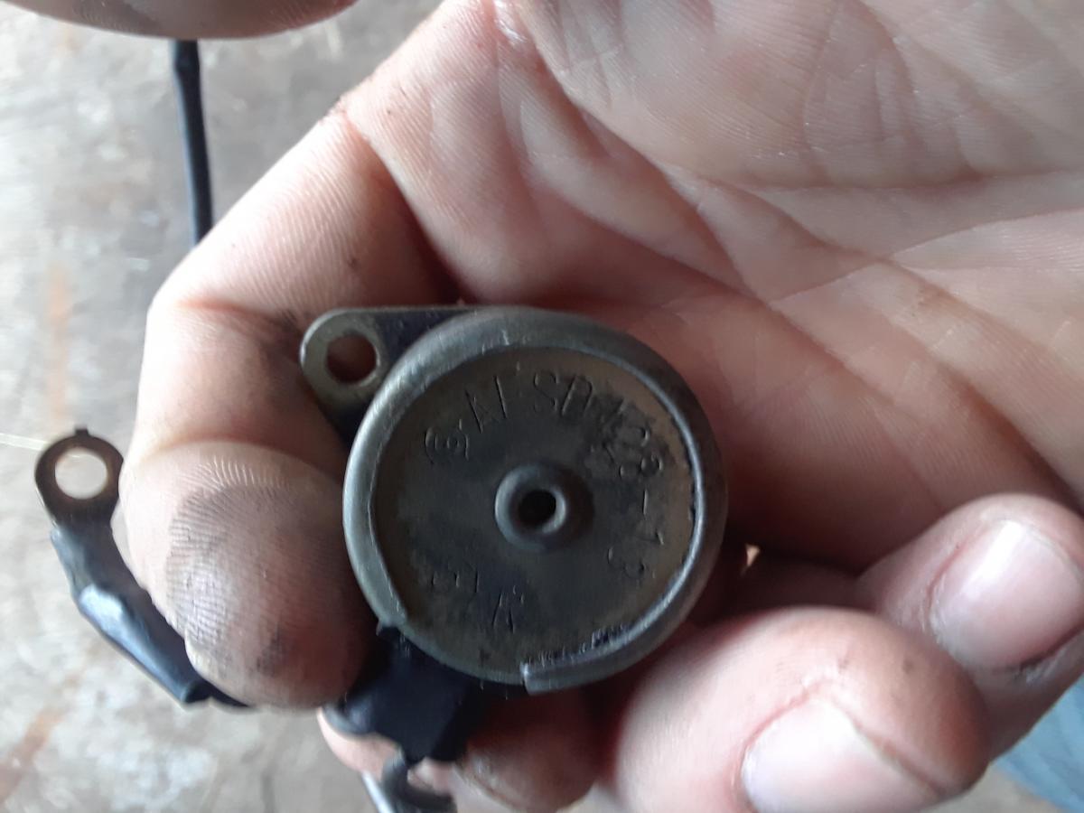

February 20, 20188 yr Author <a href="http://s50.photobucket.com/user/Michael_Allman/media/15191659516442107922428_zpsjqywjkd3.jpg.html" target="_blank"><img src="http://i50.photobucket.com/albums/f338/Michael_Allman/15191659516442107922428_zpsjqywjkd3.jpg" border="0" alt=" photo 15191659516442107922428_zpsjqywjkd3.jpg"/></a>

February 20, 20188 yr well i think now you're using the actual forum bandwidth, but its fine, we can all see it, oh and i have no idea what that is, having own 4 EA82's, i have no idea what that is, guess it was something i never bothered removing.
February 20, 20188 yr Author Well I bought this car from my idiot brother in law and it was supposed to be an easy carb rebuild fix but I'm not getting any spark and finding parts all over the car soo... yeah

February 20, 20188 yr Ok looks like the Bowl vent solenoid. Should not be part of teh no spark but it will consume TONS of gas without a working one.
