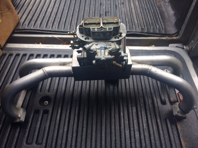

August 7, 201510 yr Very interesting reading. Think I'll read it twice lol Here is my trike exhaust with that common pipe.

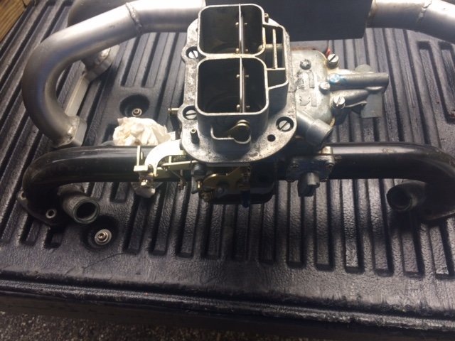

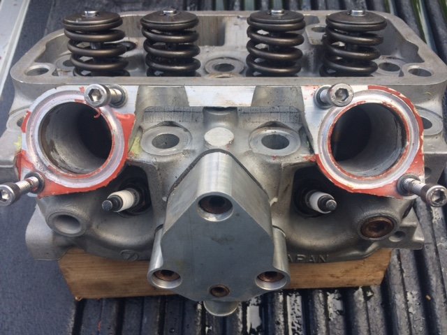

October 4, 20187 yr I have the Ram Dual intake EA81 heads with stainless oversized valves, bronze guides and HD springs with only 25 hours of use. I also have the Ram custom Aluminum Dual intake with a like new Weber 38 carb. Serious HP gains with this set up! I also have a custom single intake with a like new Weber 32/36 carb. I will entertain any offers. I can be reached at 860-86six-61zero4 or PM me Edited October 4, 20187 yr by culater
October 6, 20187 yr goodness me ! I wonder if it was made to fit under the standard height bonnet? Is there a specific cam to go with it? Is something like this also good mud puddle crawler or would it dig your way through the other side of the world?
October 8, 20187 yr It's good for flying with Jono! i hunk it's got a flat torque curve - an important feature of an aircraft engine as far as I know. Cheers Bennie
October 25, 20187 yr On 10/5/2018 at 9:57 PM, jono said: goodness me ! I wonder if it was made to fit under the standard height bonnet? Is there a specific cam to go with it? Is something like this also good mud puddle crawler or would it dig your way through the other side of the world? These heads will work with any cam and also fit under your bonnet. A K&N high flow air filter also comes with it. these Ram heads with the custom intake and Weber carb were over 2500.00 I will sell for 800.00 plus shipping
