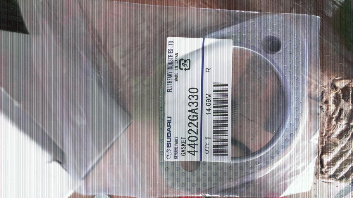

These are the gaskets I got for my manifold. I believe they are the right ones, they fit and the exhaust no longer leaks. Plus the new stud and helicoil is tight so everything finally worked out.
