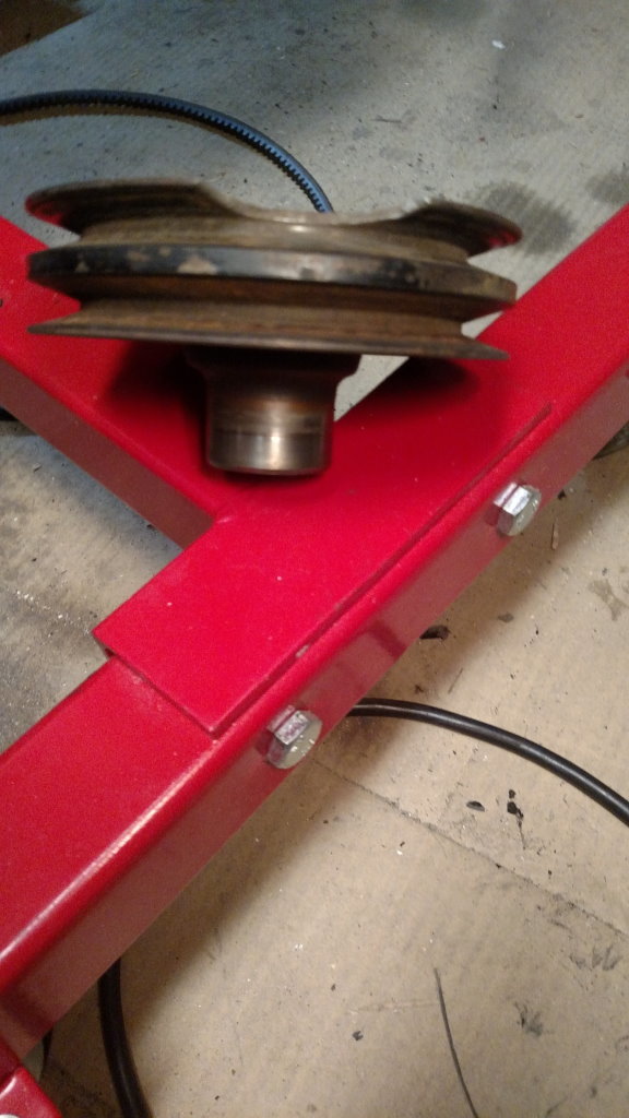

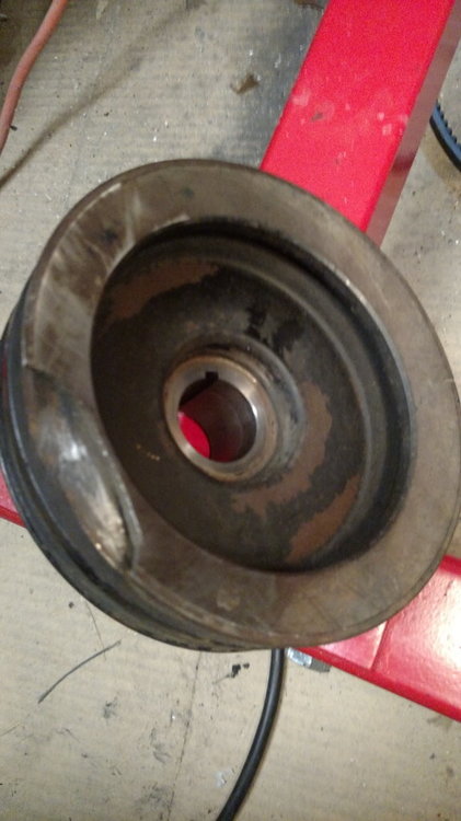

can my ea 71 crankshaft pulley be repaired by welding in a piece and grinding
I am looking for a crankshaft pulley 5.25 dia 2 v groove for my 1978 1.6 l  ea71 engine.
I have been looking on line for it but not yet located one. Grangers may be able to help but not getting hopes up just yet.
I am now thinking of welding in a piece but not sure what alloy Subaru used for the casting

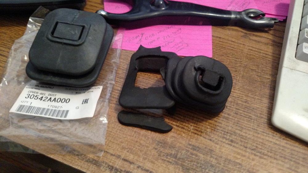

Also I am looking for a clutch release lever dust boot. bought one off E-Bay but it is too big (possible to cut it up to make it work).

Sounds iffy.I`d get a used one.
Plenty here http://www.car-part.com/cgi-bin/search.cgi
Make some calls or try a classified ad on this site.
You are lucky in that yours is a common ea71 pulley.
Any ea71 from 1976-79 or an 80 manual trans are suitable doners.

With respect to the "cultch release lever dust boot"
I do not know part number.
But if that is it and it fits may 1978 brat ea71 manual trans than great.
do you have one.

I neither have nor know the part number for the boot.
Even if you found a NOS one it would be old and cracked by now.

I had to ask.
I did not really expect someone to have a new one laying around.
That's why I picked up the oversized one that I can mod to work.
it's job is to keep stuff out of the clutch works.
For that mater Duct tape would even work (Cheesey looking but will do the job).
Sorry to disagree. Not all rubber New old stock is dried out. I retain many NOS rubber bits including the clutch lever boot which I’m trying to locate and match for our friend here.
In general yes old rubber can’t immediately be trusted. But Subaru packaged their goods well.

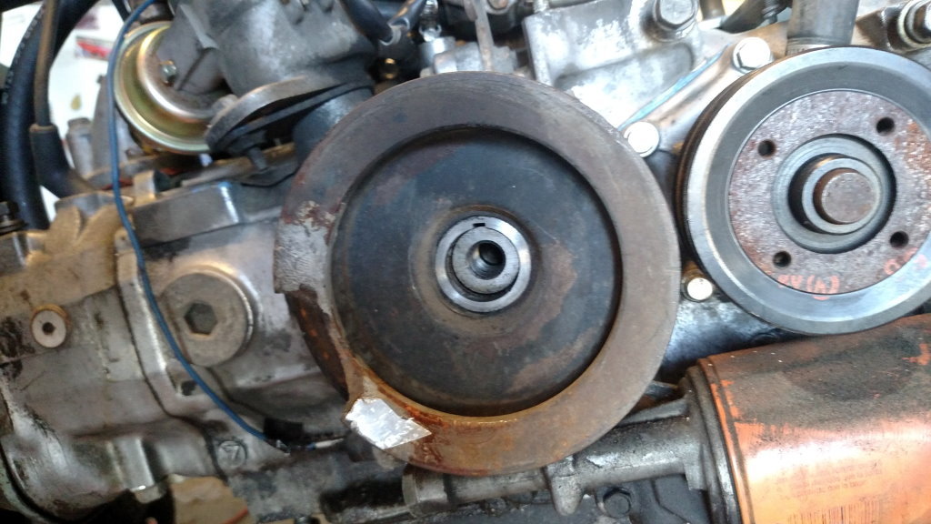

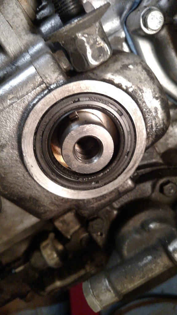

The rubber part is not for the crankshaft pulley. it's for the clutch release lever it's just a dust boot.
The crankshaft has a seal as NARU 2 has pointed out the need for. The pulley seal dampener is in great shape as can be seen.
The pulley is what I need to find......
FYI the dimension are as follows: outside pulley  dia is 5.31 inch or 134.9 mm dia, inside shaft opening ID 1.095 inch or 27.81mm dia
and the outside sealing surface dia is 1.495 inch or 37.97 mm dia. any help is REALLY welcomed and very much appriciated:clap:

Same place might have a clutch boot-nobody will list that.

Why not repair it?  It’s not aluminum or stainless so shouldn’t be a big deal to weld a chunk in there.
It looks almost usable as is and not much is needed. Cover it and keep that edges from hitting the belt.
Machine shop accustomed to custom work could do it.  Some could make a new one from the dimensions.
Got any local large businesses you could ask the machinists to do it?  As an engineer I’ve been around large global corporation machine shops and was surprised some of these guys have milling machines at home and can whip out a pulley rather easy.  Worth an ask if there’s any local entity like that v

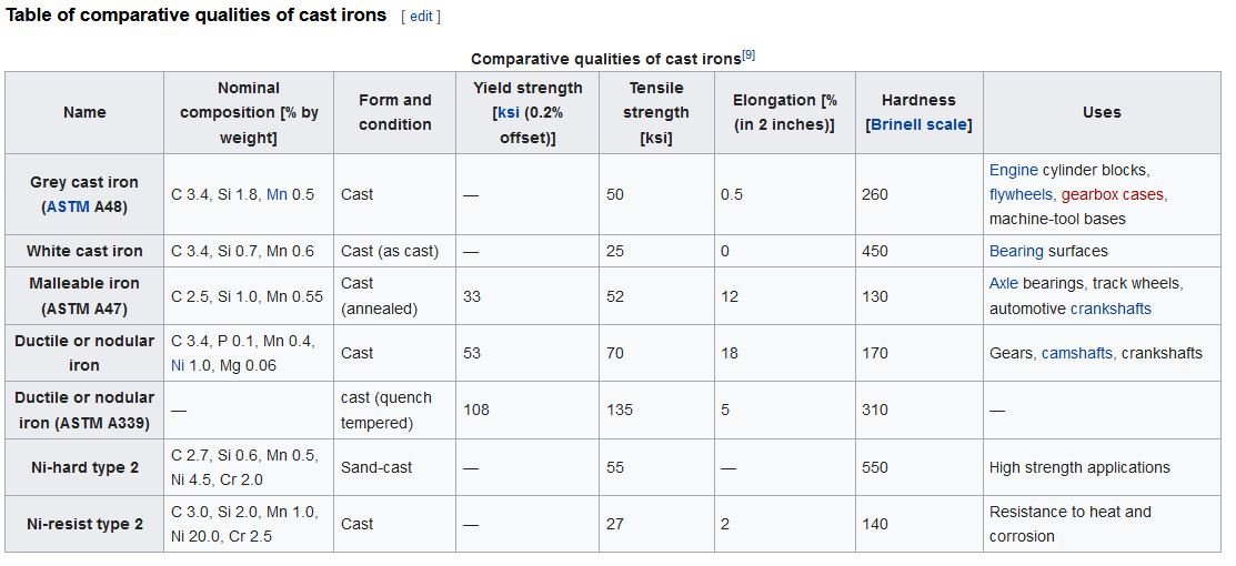

As and Engineer both a Mechanical design and Electrical (retired thank you) myself I know that I can get it repaired with little issues once I understand which type of cast iron it is.
I tend to think it is Malleable iron ASTM A47 BUT it could also be Ductile iron ASTM A339
Short of having it tested and making sure" myself" or the Shop I take it to can do the job correctly, and short of making a cad dimensioned model of it.
and while I have retired and working buddies with big toys in there garages
It seems to me to be easier and cheaper to find one some where.
And yes it is usable as is. I have been running the car of years with no damage to the belt.
I was surprised that the dampener seal was not trashed.
it's just that I currently have the engine pulled out and thought it would be a good time to replace or repair it.
Which is what my first question was (has anyone attempted it before and been successful).
