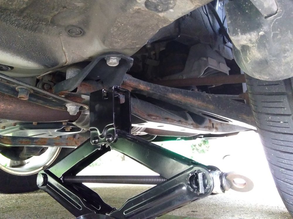

I would like to lift the 2014 from the jack point in the picture, and then put a Jack Stand under the pinch point.  I need to lift 3 3/4 inches.  Do you think that this lift point would support the car without deforming?   The jack would be right on bolt head shown in picture.  The photo is taken looking toward the front of the car.

Do NOT use a jack stand on the pinch weld. You will collapse it. Use the jack on the pinch weld and put the jack stand under the frame rail.
GD
GD
+1
the scissor jack is made to fit over that pinch weld.  That's what the slot is for.
Although, since I see you are in Wisconsin, lifting from the pinch may be risky.  Don't know how much rust yer car has.
you should get a good floor jack, and lift from the center of the front crossmember, then put your jack stands at the point you have pictured above.

I'm sorry that I didn't explain in my original post.  My jack stands have hard rubber adaptors that I bought so that they fit the pinch points better then the scissor jack.
The problem with the floor jack is that the cheap ones [less then $100] are designed for a lift to only 13 inches which is hardly enough,  and there are questions on the internet if they actually can get that high and hold the height long enough to get a floor jack under the car.  And anyway, in the case of using the floor jack on the front crossmember, where would the floor jacks be positioned?  Is the position that I show the frame rail?

When you use an actual lift, the lift arms have rubber pads that spread the load on the pinch across about a 5" length. These pads have to be replaced periodically as the pinch welds from hundreds of cars eventually cut through them. Ask my ebay account - I have bought about 50 of them for my lifts. I own 5 - used to own 6 but ripped one out for a 2000 HP chassis dyno. I might know what I'm talking about BTW.
I would not trust a rubber pad perched atop a jack stand. That's suicidally stupid.
The scissor jack is really for emergency use to change the tire - is only designed to lift the car till the tire clears the ground. It is not a service tool, and will not hold up to that use. After a few dozen uses you will wear it out.
The floor jack goes on the "Jacking Plate" that is designed expressly for this purpose. It is located directly aft of the oil pan.
You have a 2014 - buy a proper jack ya cheapskate!
Or - there's about 3000 lbs of DEATH awaiting you. Please film it for YouTube.

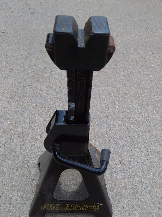

So I put new pads on the front of my 2014 subaru.  I'm still a little curious of where people put the jack stands, but in my case i use the pinch welds with a hard rubber insert on the jack stand as shown on the attached photo.  It works great and is very stable.  It doesn't do the pinch weld any harm.

the jackstand should go under the subframe. using the pinchweld area where the emergency jack is used is never a good idea - even with the blocks.
You want the jackstand positioned in a solid area that will support the weight of the vehicle - the pinchweld is not designed for that.
The frame rail is a rectangular tube of unibody that runs from front to back.  Shown roughly mid picture.  There are two.  Runs parallel to the pinch weld.  I have used both with jackstands.  Always give the car a good shake before crawling under.  Just my ritual.  For rust belt cars I place a block of dense hardwood under the frame rail to spread out the load.
