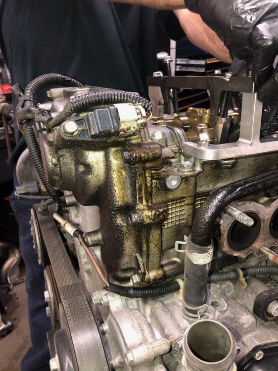

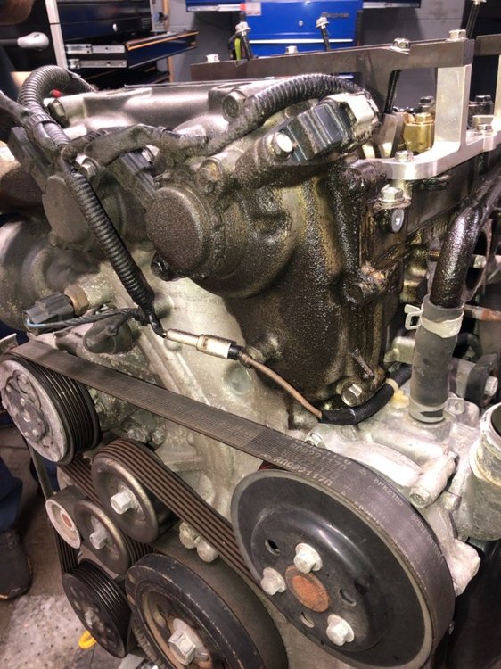

I have a 2013 Impreza Sport 98K miles. My subie is currently at the dealership in Ohio for the engine valve spring recall and of course they find something major for my free service. The wheel bearing and rotor I believe need  attention because i hear a quiet rubbing noise while driving, but the timing cover and cam carrier reseal caught me off guard? My car has never leaked visible oil. I just had my Subaru mechanic do my 90K mile service in March and this wasn't seen.
Do the prices quoted below seem fair? I'm not seeing any leaks on my practically white driveway, is there really an issue?

TIMING COVER & CAM CARRIER COVER RESEAL - $923.95 (LEAKING OIL) NOTE: LABOR SAVINGS OF $550.00 IF DONE W/ RECALL

Other useful information.. the same dealership forgot to put my oil cap back on after a routine oil change (a few oil changes ago), completely emptying my oil and needing steam cleaned.. They emailed me photos after I said I wanted to decline, with the following response:
On Thu, Jul 11, 2019, 2:32 PM JOE  wrote:
Ok I will let them know we are holding off on further repairs. The leak is not very big, but is present. Was founs on engine removal. The leak would be directly above your exhaust so it would not stain a drive way due to the exhaust burning the oil up. I will perform the recall and re-seal the valve covers with the recall. The front timing cover and cam carriers are not part of the recall. I will make all notes for you. The car will be done today. We will test drive after, Will tomorrow work for pick up?

Yeah it's usually about $800 for us to do the front cover. Of course that's with the engine in the car. Not out on a stand. But dealer rates are much higher than us. I would likely quote that job at about $650 given the engine is out. What I know of dealer rates that's about right in line with my quote. It's not a small job.
But that may not be the cover - might just need the phaser o-rings on the front replaced..... or it could be both.
