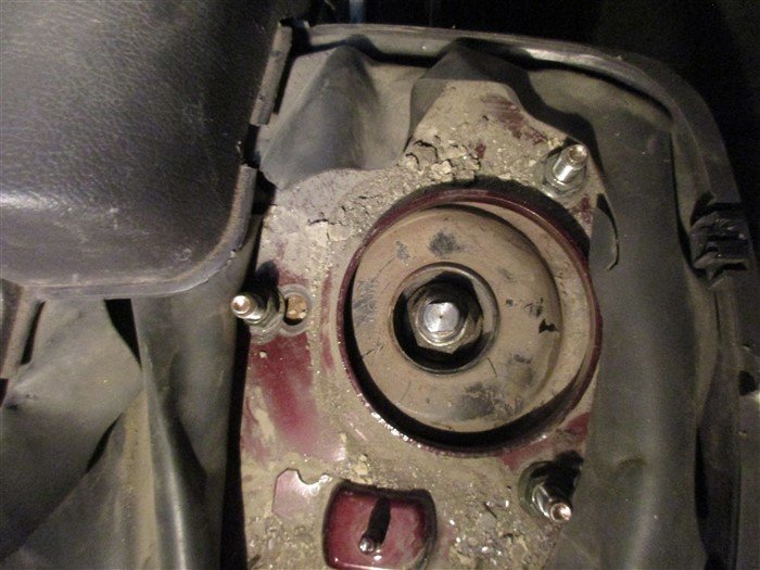

Front went on perfect without issues, we got to the back and drilled 1 new hole (towards the outside) and used the other 2 factory holes, we mounted the rear strut, and it bolts up fine except, looking at the top from inside the car the large middle bolt is off center (see pic below) just wondering if this is for sure okay or if we need to drill 3 holes that would bring it back to center?

i miss montana! grew up in the bitterroot. welcome to the forum, i would take a burr grinder and elongate the other two holes enough to allow the strut to seat. if left like that it will deform the strut tower quickly and cause future headaches

Should have swapped the Legacy Tophats onto the Forester struts.  The way you have it now has the strut top tipped out further than it should be.  This will cause positive camber, which is not a good thing.
FWIW, 99 Outback rear struts will give you more height and tire clearance.
Personally I would swap the tophats now, and not hack up the body mount any further.n  Maybe get some outback rears and use those with proper fitting Legacy tophats.

Thanks  much for the help guys. I have a spring compressor rented and will see about switching the top hats over in the next night or two and let you know how it goes.I am working on several projects all at one time, so a bit late on my reply. Hey Crawlerdan, I am in the Bitterroot also. Stevi area. Montana the last best place. :)
