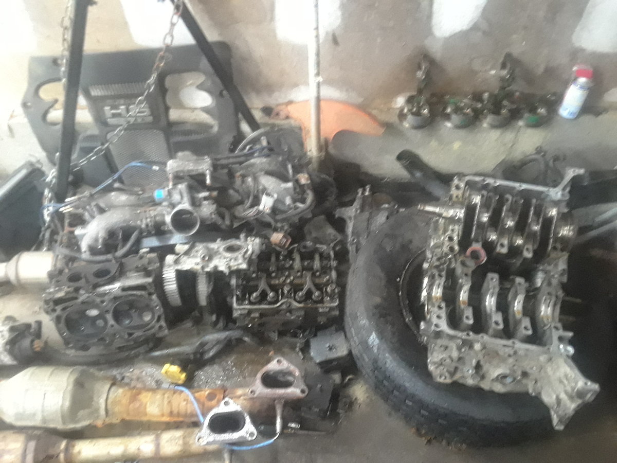

Well that forester engine turned to hell. I tore it down and got the pistons out to find rod play in all of them. Not alot but still there. We split the case and pulled all 4 rod bearings they were pretty much toast but the crank is good and measures in spec and the rods measure in spec. So if I keep going this route it's new rod bearings new rings and new head gaskets as well as all the small o rings and crap to reassemble the case.i will also not use any other part of it besides the block. The heads were full of sludge the oil pump sludge oil pan sludge starting to wonder if I should bother with this block or not. I mean the clock looks good and is in spec but where els could sludge be that I cant clean out?
This is not the engine that was in my car. This is another engine I had sitting around from a 2001 forester I parted and scrapped. I might just spend the time and redo this block. At least I'd know it would be like new inside when I finished and shouldn't have to worry about engine issues again for a long time.

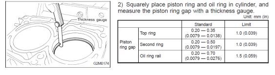

See picture for ring end gap. The pic is for an EJ22. See what the end gap should be for yours in the FSM. The rings wear and so do the cylinders.
Knurling is cutting a diamond shape into the outside of the piston with sharp wheels to give it a slightly larger diameter to prevent piston slap. It depends on how much the cylinders and pistons are worn, if the pistons need this or not. The wheel is like the cutting wheel in a tubing cutter. When it cuts into the metal it causes the metal on each side of the wheel to raise up.
