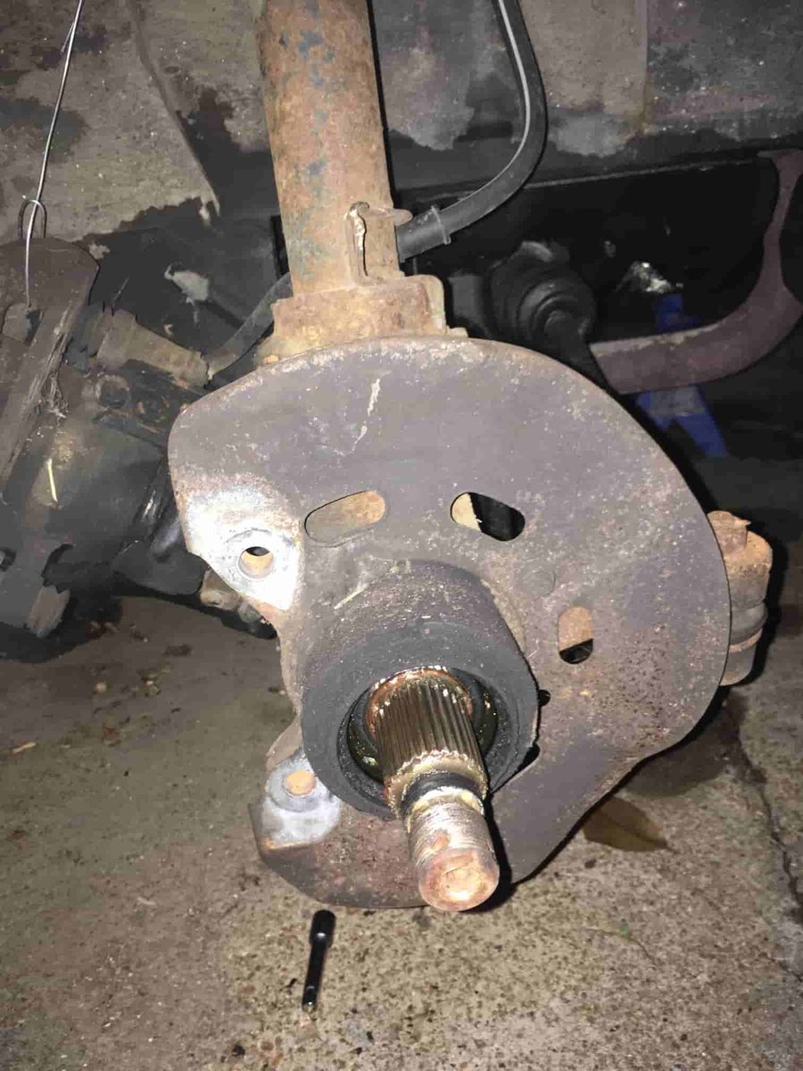

Front, replacing axle shafts, etc. Should I replace wheel bearings?
I need to replace the front axle shafts.  The seriously "clunk clunk"
I plan to replace a lot of other stuff while I am at it, such as tie rod ends, ball joint.
I have new wheel bearings and seals.  The ones on the car seem to be holding up just fine.  Replace them, or not?

I brought the axle shaft/ bearing housing to a place that has a press, and they acted like it is a big risk to pop the axle shaft off.  The tech said the axle shaft might be destroyed.
I am looking at another option...
Same old CVJ and bearings, new outer boot, but new DOJs and boots.
The mechanics here have me spooked about removing the axle shaft.  Where would I buy another bearing housing?

How I get the axle out of the hub-  Remove the thin sheet metal brake shield.  2) 12mm head bolts.
A BIG 2 arm gear puller can just get a hold on the housing in one position, and push on the end of the axle.  That usually does it.  Some are looser, and hammering on a block of 2x4 wood against the axle end will push it out.  Do not use a hammer directly on the axle.
