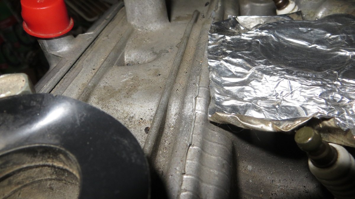

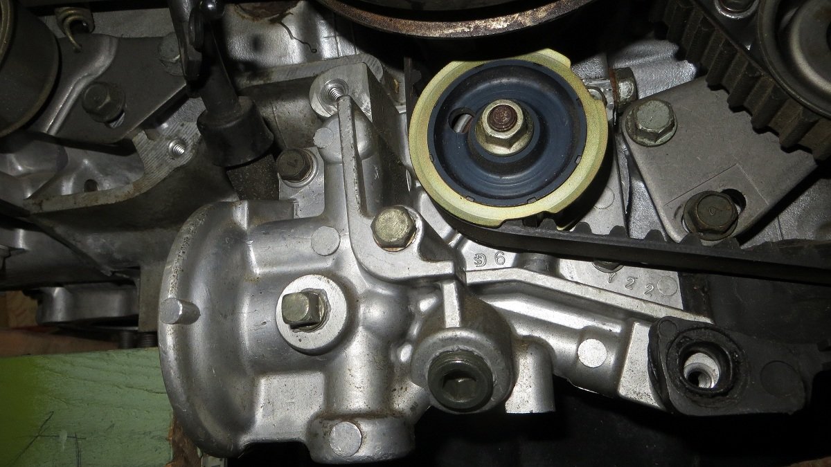

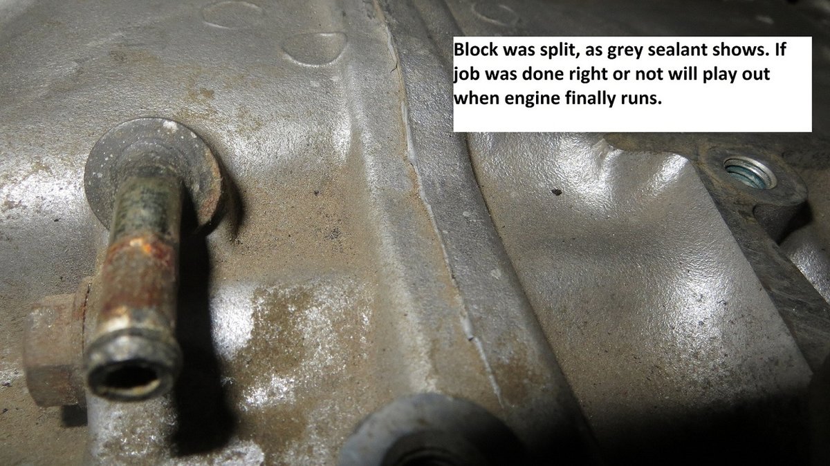

December 31, 20196 yr I just picked up a rebuilt EA82. Never run since rebuild as no oil inside yet. Only assembly lube is visible. Seller had no history, but this rebuild was done some years ago. Timing belts say "Three Star" brand, which seems like an older brand. Head gasket are definitely not Felpro perma-torque. All signs say that a re-torque of heads will be needed after installing engine into Loyale and running up to temp. Doing a re-torque while engine is in this car is not a fun task. PLAN B- Since engine is not yet installed - can simply re-do using Felpro perma torque gaskets and be done with it. Edited December 31, 20196 yr by rickyhils typo
December 31, 20196 yr I'd probably set it up on my stand for a test run and retorque unless a car was down and I needed to swap right away.

January 2, 20206 yr Oh, you reminded me - before I put the timing belts on, I use a drill with a socket to spin the oil pump to prime it after a reseal.
January 2, 20206 yr Author 6 hours ago, DaveT said: Oh, you reminded me - before I put the timing belts on, I use a drill with a socket to spin the oil pump to prime it after a reseal. Maybe I would do well to look inside oil pump to see if assembly lube was applied. That could only help create the needed vacuum to pull the oil up. Speaking of which, whenever I hear the EA82 "tick of death" I could always shut the engine off then restart immediately and the "tod" would disappear. Is that due to a gasket that gets sucked out of shape? And is there some kind of check valve in the oil pump to keep it primed until next startup? Thanks
January 2, 20206 yr 7 hours ago, DaveT said: Oh, you reminded me - before I put the timing belts on, I use a drill with a socket to spin the oil pump to prime it after a reseal. I too did this after my initial rebuild of the EA82. Money that would’ve been best spent on an EJ conversion. If you ever rebuild an engine and don’t know the history of the radiator with plastic end tanks - replace it!! My dodgy old radiator cost me a 9 month old rebuilt engine Cheers Bennie

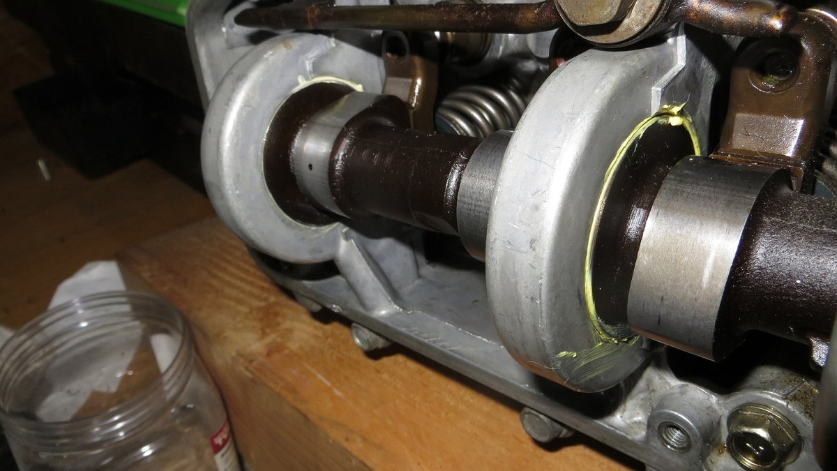

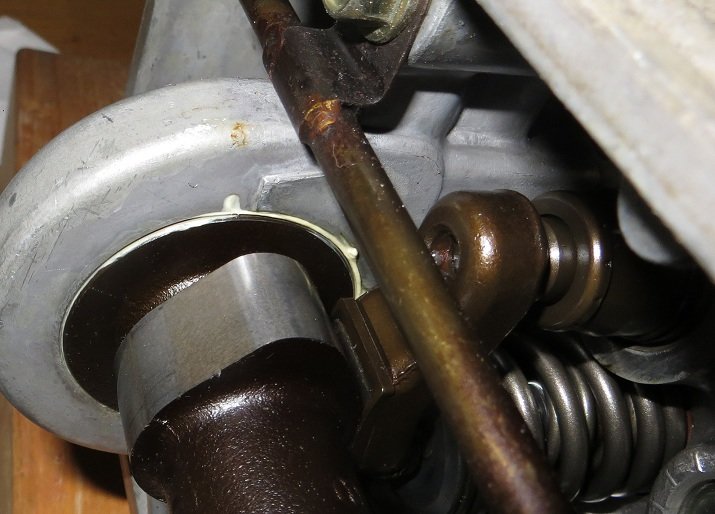

January 2, 20206 yr Why replace a known running engine with questionable? I don’t think I’d retorque the bolts but If you’re going to retorque in the car, pull the cam carriers, clean all the mating surfaces and install them dry or with a very easy to remove sealant. Pulling the cam carriers insitu on an EA82 is pretty easy, cleaning sealant off is probably the most time consuming part. Can you find a junk EA82 to buy and a test rig then sell it when you’re done? Or just buy a cheap Subaru to drive while you “test” the engine in your currrnt car if down time is a concern? If you’re able to build a test jig then buying and selling a Subaru is a cake walk. Both of those sounds easier than fabricating a jig for what is probably a one time stint and loss of money and time. Compared to building your own test jig and running it on a stand - just installing the engine and running it or retorquing or installing Fel Pro HGs all sounds simple.

January 3, 20206 yr Author 3 hours ago, idosubaru said: that’s a fair number of miles! New engine it is!!! I use grease to hold rockers in place. can also tilt the engine or entire car with a jack so the side you’re currently working on is “leaning slightly”. by not retorquing I mean I’d rather not retorque and would install new Fel Pro PTs out of the vehicle rather than retorque in the vehicle. *temporarily* install the cam carrier dry only if youre going to remove the carrier to retorque. Install carrier dry, remove carrier to retorque, *then seal* the carrier after the retorque. This rebuild has "MBL Three- Star" timing belts on it. That's an older product. Would more likely see Mitsoboshi name now days. And the HGs are for sure not Fel Pro. This could have been rebuilt 15+ years ago. The seller was into working on VW bugs and just had this sitting in his garage. He gave no history info at all. But for $100 bucks who would pass it up? Final decision is to re-do using Fel Pro PT HGs. Will keep in mind priming of water and oils pumps. The supplied intake manifold is for a carb. I looked the block over and the only possible difference from my 1991 Loyale block is maybe the odd little bracket mount to secure an A/C line at the top/right cam tower. Can fabricate. For the cam carriers ----> Permatex 22074 Ultra Grey?
January 3, 20206 yr Author Will update progress on this "rebuild find" in coming weeks. And before the new Fel Pro PT HGs go on I'll get some pix of the cyl walls. It does crank over smoothly by hand, but at this point one can only pray that the bottom end was done correctly. Will go with conventional oil as original. The radiator checks out ok and runs cool as a cucumber. All you guys here are great. Thanks a bunch.
