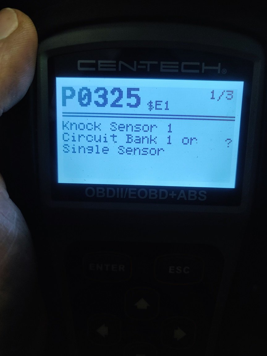

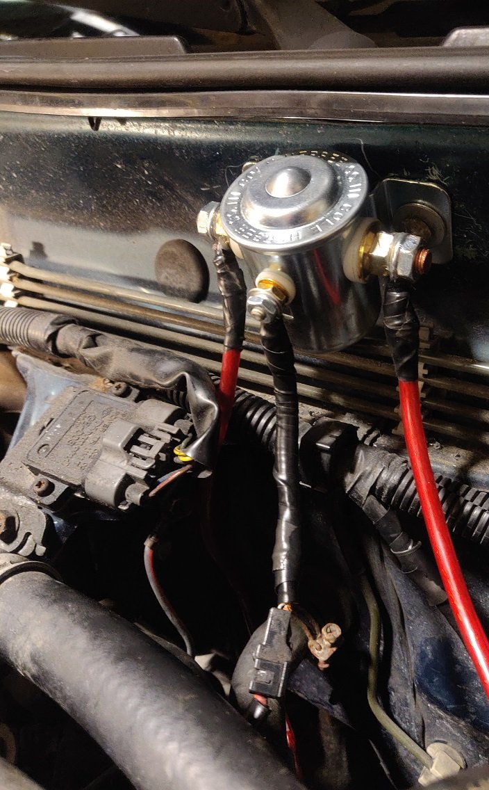

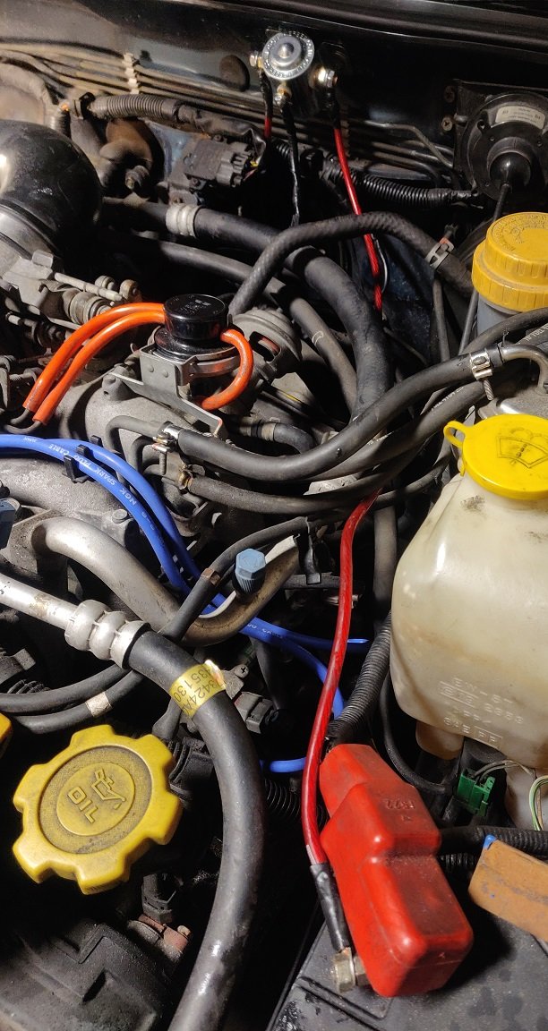

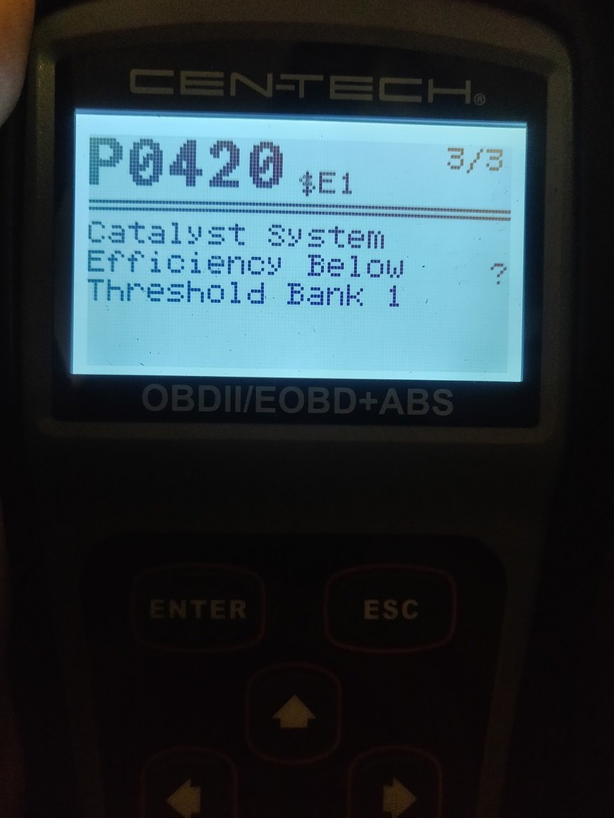

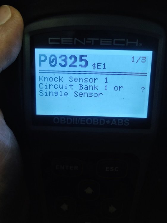

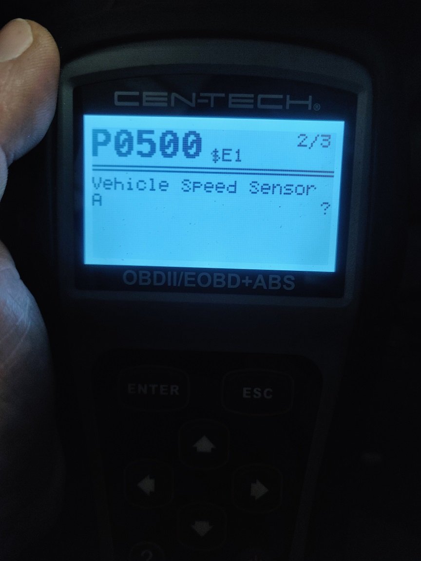

Afternoon Guys was wondering if this looks right to you (mikec03I hooked up a high voltage solenoid going to give it a try and see if I have the same issues usually happens once a week so I will keep posted as for the codes its throwing (idosubaru) I have attached pictures below any input would be great let me know if you thing its the Cadliac Converter and if you know of a reasonable place online to get them I am going to get the knock sensor that may explain why the car is sluggish a bit and poor gas mileage also I am dealing with the good old Subaru oil leak onto the exhaust looking to be coming from in between the transmission and the motor any idea on how to fix that would be great also, let me know you guys and again I appreciate the help

Fix the knock sensor first.  OEM is best long term but I’ve had used plenty of $8 eBay ones without issues yet.
0420 ensure there are no leaks and good maintenance - plugs, wires, air filter, new PCV valve
The new PCV valve is cheap and easy and may also reduce oil leaks (but don’t get your hopes up)

on a tank of gas i probably get 250 miles  I think that  is not very good at all does that sound right to you ? I will put it up on the lift in the next few days and take some pictures where the oil leak is it looks to by what you are saying the rear separate plate that seems to be common problem I heard is there any way to fix that without all the work ? the car only has a 110,000 on it and is in very good shape with no rust so I would like to fix it and make it run right I also have replaced  plugs, wires, air filter, new PVC valve no luck could it be a plugged converter I will going to replace those was not defiantly sure how to tell if there are really bad or not any way to check them ?

When it happens measure voltage to confirm you have 0 voltage on the thin black wire with spade connector that connects to the starter.  I have chased this issue for a few years.   I see you added the workaround.  That will fix it for good.   What is the part number of that solenoid?  Any chance you could describe on that pic what connects to what.  I get around 280 miles per tank. 97 2.2 with 260k miles in a 98 OBW
Ok that seems about right for the milage I think my gas gauge is not reading correctly , I just get a smell of raw fuel sometime when I start it and it goes away but  I feel like the car is kind of sluggish lately I just recieved in the beck arnley knock sensor I will put that in over the weekend see if that helps anything , as for the work around on the solenoid the #Part No: 24106-BX I ran a wire directly from the battery to the right side of the solenoid and the single wire going to the starter up to the new center post on the solenoid which I believe is the energizer wire then the left side of the solenoid goes back down to stater engenizer wire, seems ok I haven't had a problem with it for a few days now hope this fixes it for good, let me know if you think the catolica converters need to be changed cause of that P0420 code
