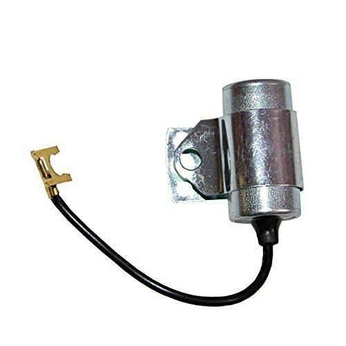

I have a 90 loyale that has a no start I have replaced the coil and there is no spark right after the coil I am wondering what these plug goes too will show in picture it is the same kind of plug that plugs in the the transistor the weird thing on the ig coil bracket

Only other connection to the coil is the noise suppression capacitor on coil positive.

whay do you mean by the capacitor
