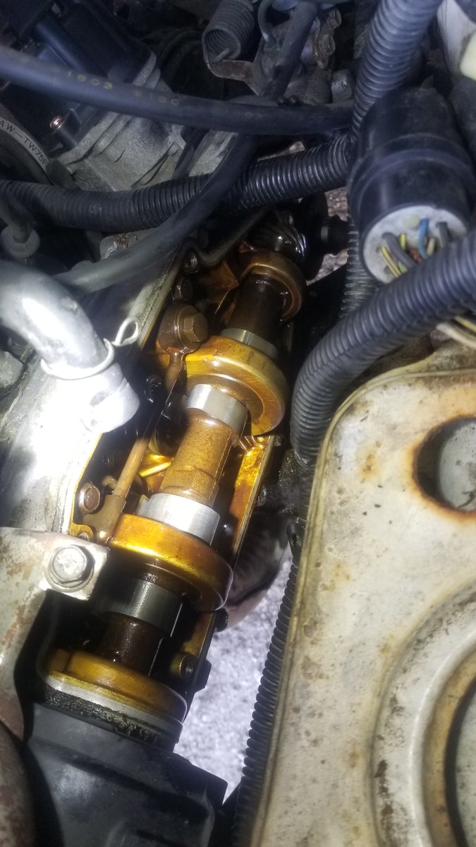

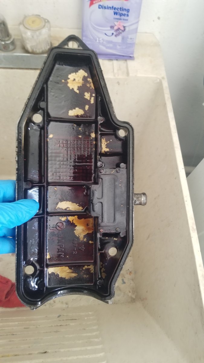

The poor ea82 in my loyale wasn't maintained very well by the old lady previous owner. I decided to try a engine flush product, and was actually surprised it worked. I had just done the valve cover gasket and both covers were 100% covered in sludge. It was a thick layer, enough that you could scrape it off with your finger. I bought a cheap engine flush and ran it on the next oil change. The stuff is basically diesel fuel with some additives. I lost the before pics, but you couldn't even tell they were aluminum. In the head the only thing that looked like metal was the cam lobes. Now there are clear sections of aluminum! The cam and caps cleaned up amazing. The cover wasn't as dramatic, but I think that's because it dosent get as much oil flow. It has to of cleaned a pound of sludge off the heads!
Nice and rare to find just a golden tinge to the internals instead of black carbon crudge the norm.
I pulled one of my rebuilds apart after 120,000 km ( because I had to :( ) . Pristine,like new inside after 8 years due to oil and filter change every 10,000 km

It wasn't all golden before the flush!
