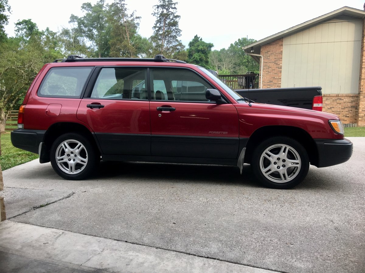

August 18, 20205 yr I wish I could help technically, but just want to say from the photo I'd agree that car is too nice to give up on. Really nice wheels - and is that a stock Subaru color? I don't think I've seen it before. Makes me miss my 2002.

August 18, 20205 yr Author 35 minutes ago, Stelcom66 said: I wish I could help technically, but just want to say from the photo I'd agree that car is too nice to give up on. Really nice wheels - and is that a stock Subaru color? I don't think I've seen it before. Makes me miss my 2002. yes its all stock except stereo and wheels.... its had an older respray once upon a time but it matches factory paint perfect....
