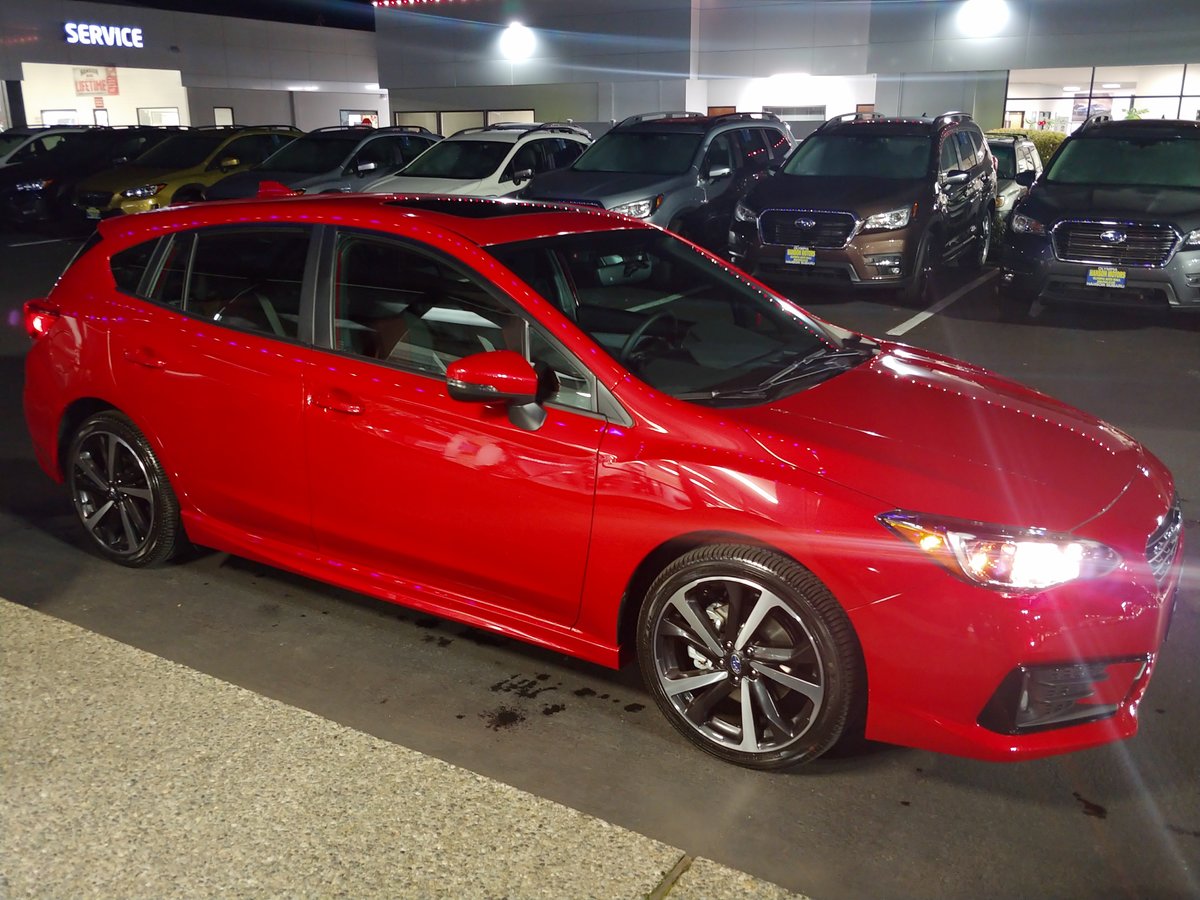

December 17, 20205 yr My wife just got a 2020 Impreza Sport and came home tonight complaining about it being unstable on wet roads. She said it was all over the lane and the Eyesight function was going on and off. So we went into town, took the freeway and I drove. I turned off the lane assist (keeps you in your lane) and didnt have any issues. I had a few instances with hydroplaning, but it wasnt bad. She commented that there was more water on the road than where we were at the time of our test drive I told her to turn off the lane assist the next time the roads got bad and see if it still does it. Anyone else have Eyesight/Lane assist ever encounter this?
