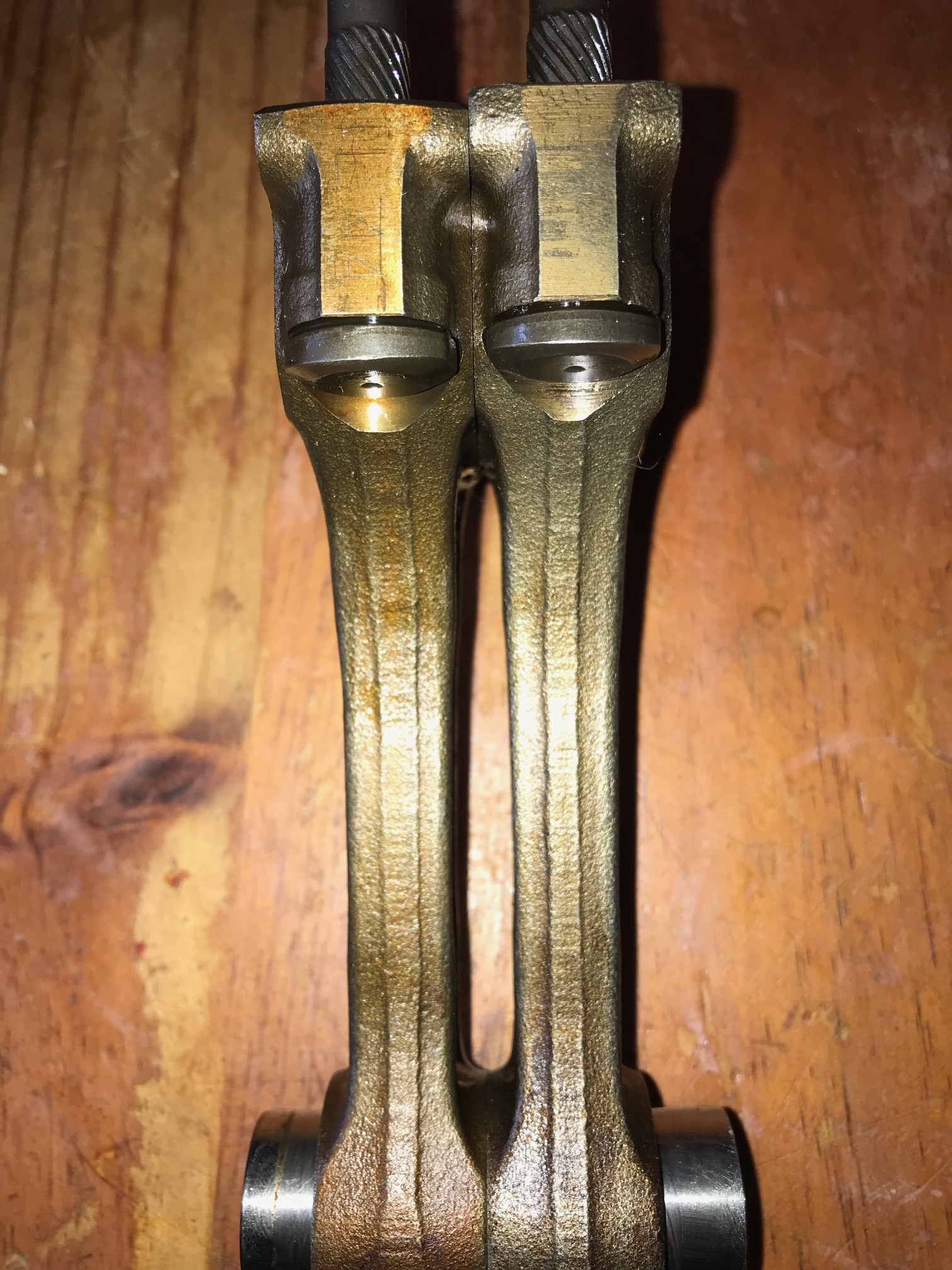

March 19, 20215 yr Author Awright, here's what I've got. Hoping Smart People (tm) can enlighten me. Pulled "new" block apart, with the pistons off felt a little play in rod 1 - maybe a couple of thou. Once I split it and yanked the caps, I could see that the bearing was just starting to come apart. I think I was lucky here, and that as soon as buddy detected a slight bottom end knock he didn't push it - he stopped and immediately pulled the engine. Will mic the crank over the weekend and confirm it's okay. But I'm really curious about the block diffs. This new one says "EJ25 304" in the casting. Where the halves mate at the top of the bell housing are the numbers 745578 (starboard) and 730865 (port) - I assume those are production serial numbers for the halves. Further over on the port side top (near the starter) is D408442, which I'd guess is the engine's serial number. Nothing that even remotely resembles a VIN. Is anything to be read from those numbers? Other than that, we've got different pistons and rods that are about .050 shorter than the '01 EJ251's. So I'm wondering: Not that I want to do this, but if I did, could I use my old pistons and rods (and heads) with the later block and crank? Or would there be little gotchas waiting to mess me up along the way?

March 19, 20215 yr Author Confirmed: No such VIN marking on any of these blocks. I do still have (somewhere outside) the borken block from our late '02 Forester, which was a US production car i.e. MPH speedo instead of KM/H. When I get a chance I'll clean it off and look, just for yuks. As for the rods... I make mistakes, but rarely any this obvious. And how are rods measured? I don't get where the 79mm comes from. Edited March 19, 20215 yr by jonathan909
March 20, 20215 yr The 79mm is not the length of the rod, but the stroke. All 2.5 engines have a stroke of 79mm and a bore of 99mm.Measured from center of king pin to center of shaft at either tdc or bdc.. That's how they get the total volume of 2498cc Piston design (placement of king pin) effects stroke. So if the piston centers are different the rod will be different to make the CR the same The cam qty does not change that. Only the deck height.
