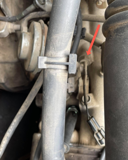

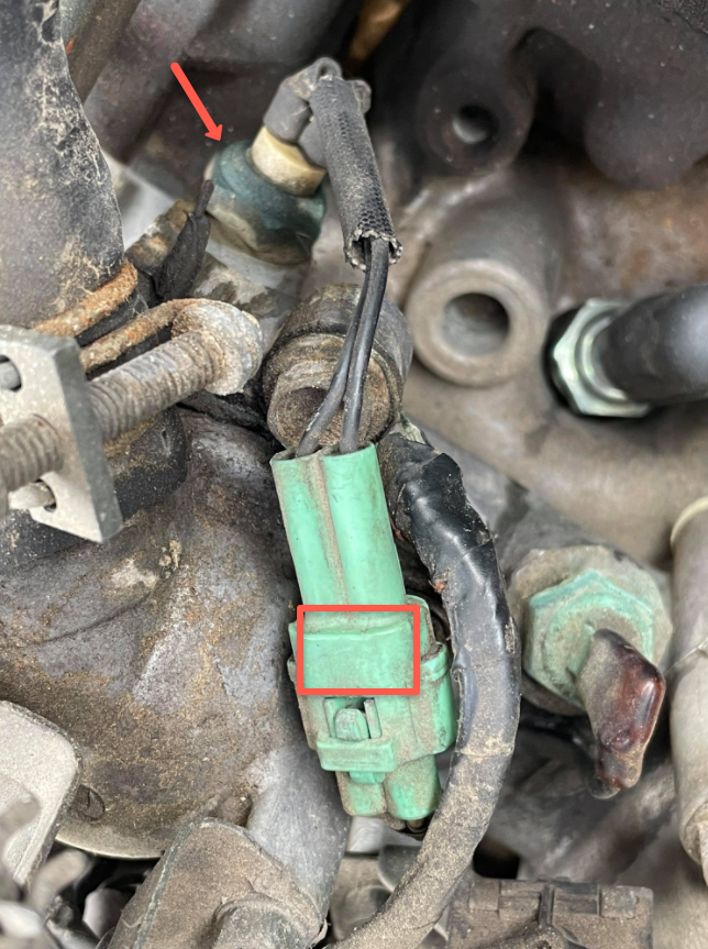

If this is the CTS (arrow), resistance at the connectors (red box) resistance seems in range from what I've read.  Ambient about 72F right now.

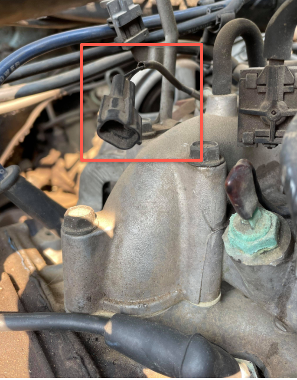

Also, I noticed this connector not attached to anything, and nothing obvious in reach.  Any ideas what it's for?

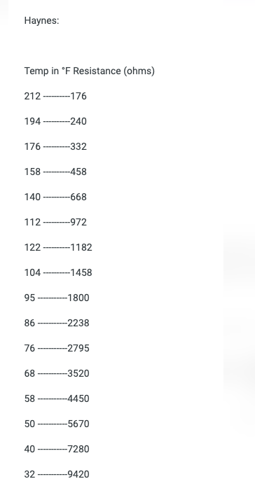

I check the CTS with an ohmmeter.  Run the engine till normal operating temp.  Shut off.  Log the temp immediately, and several time on the way back down.  If you don't have one of those IR thermometers, a meat thermometer works, just have to mechanically connect its sensor to the block.  Fill one of the unused holes with grease, stick it in kind of thing.
I have a few threads with temps vs ohms I made from values I collected of the years.
That other small sensor looks like the one on my CA car - it just verifies that the EGR is actually opening by measuring the heat in the passage.
Dunno if this is yours but I found it here.

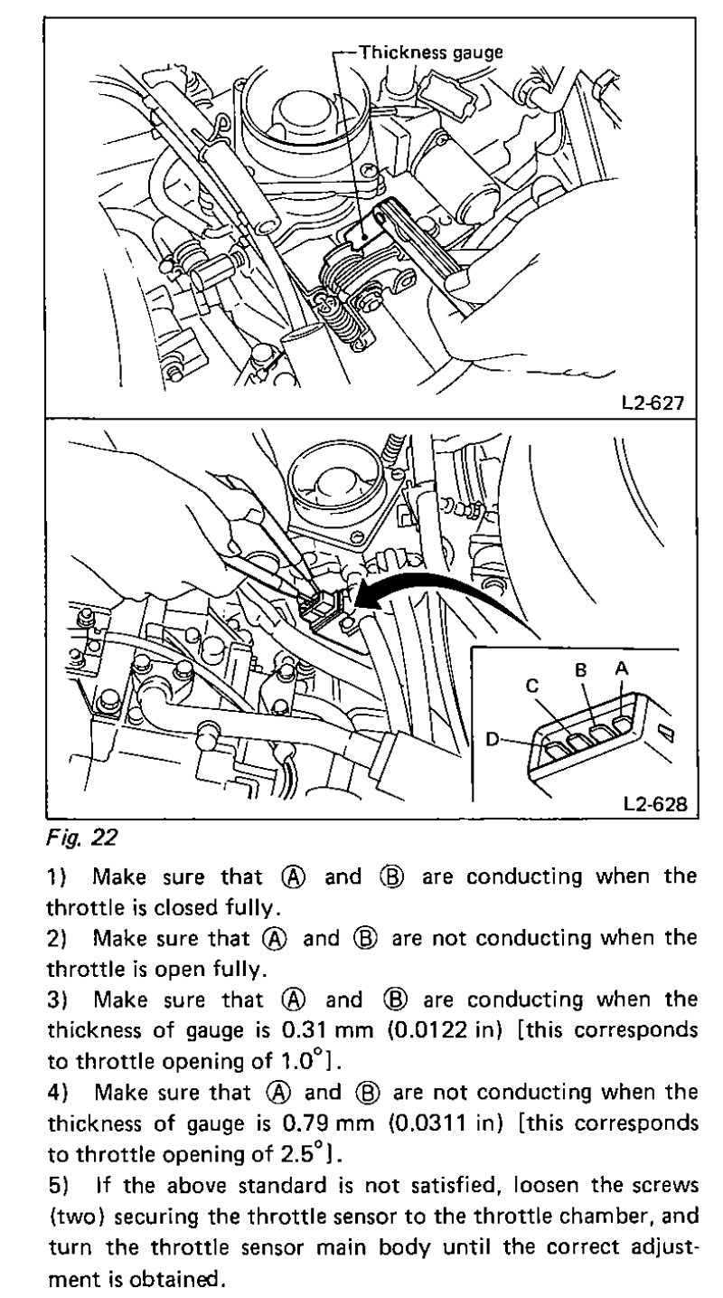

A friend helped me source the factory service manual which has been a great source of information.
Getting back to my original question for a minute - I performed the tests below and mine fails step 1.  meaning, it is not sending a closed signal to the computer.  Visual inspection suggests that the TPS is at its maximum CCW rotation, so I cannot adjust it.
Thoughts?

If you remove the TPS and rotate it gently by hand, will it read correctly? You can pop off the cover to the TPS and check the contacts, but be careful they are fragile from old age.

UPDATE:  After removing the TPS, I was able to confirm that it reads "closed" (A-B continuity) in the throttle closed position.  A-B stop contacting at some small angle of rotation, which I assume needs to be adjusted to correspond to the feeler gauge specifications.
I re-installed the sensor and rotated so that A-B have continuity when the throttle is in the closed position.
