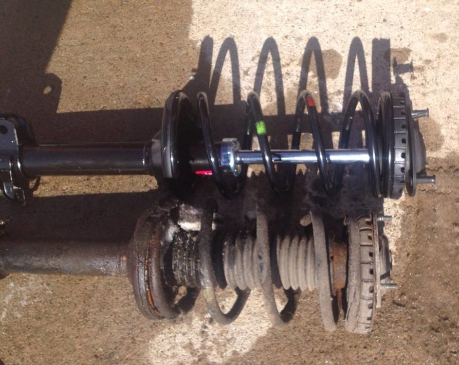

and having old, worn out components CAN make a big difference in how things sit... proof here..1014086_10201639343694569_1794220835_n.jpg
old worn out Forester strut & spring with all brand new next to it.. fair bit if difference, don't ya think? new stuff is KYB strut & tophat, OE spring
Should have the dust boot to keep the rod seal area clean and long lasting.
