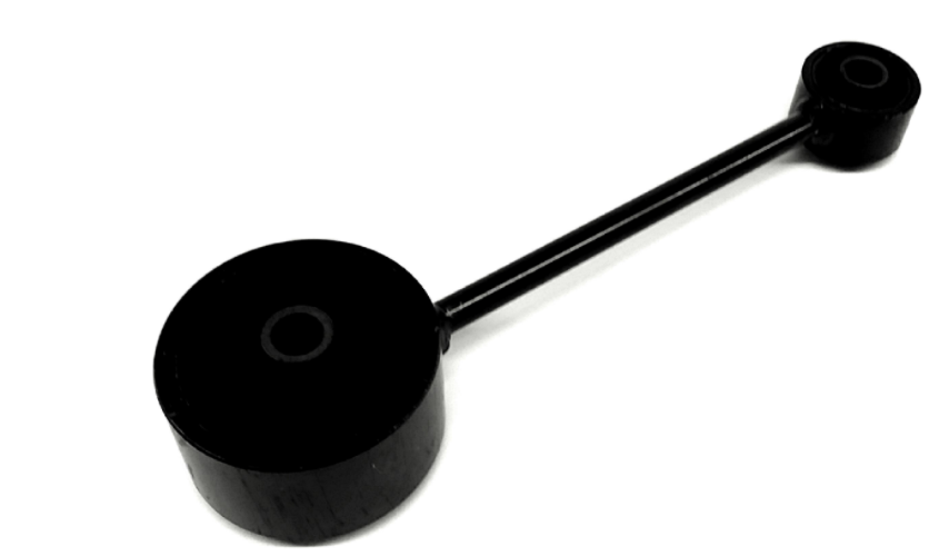

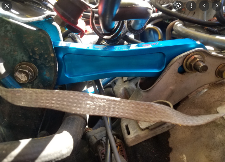

February 10, 20224 yr This is a fancy aftermarket one. Yours will be black. The Fire Wall to the transmission bracket.
February 10, 20224 yr Author I tried to upload a photo of the pitch-stop but it wouldn't. Too big. Anyway, the pitch-stop link is very crooked. I'm assuming that's a problem.
February 10, 20224 yr Author Okay. This one is very crooked, and badly bent. It's not straight like the one in the picture above. I'll remove it and straighten it.
February 10, 20224 yr Author I remembered that years ago, for some reason I had removed the pitch stop link, and knowing nothing about what it was, thought it must be normal that it was sort of z-shaped. I had to loosen the motor mounts to get it back in. This has been a problem all along! So after I took it out, I simply jacked up the engine a smidge, and it fell into perfect alignment, the starter now sounds normal again, the engine purrs sweetly again, and the vibration is gone. All well! Thank you so much!
February 10, 20224 yr Author Additionally, I straightened the pitch stop link, and it fit into place easily.
