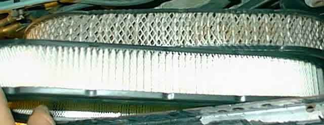

October 8, 200421 yr the easiest upgrade for a stock filter is to use a purolator . http://ecat.arvinmeritor.com/smartlink/?partnum=A23538 is the oval http://www.pureoil.com/ purolator - bottom is better than wix - used, top, look at picture gasket is better, more complete, thicker, screen is finer and has about 3x pleats
