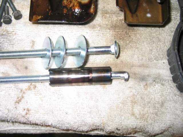

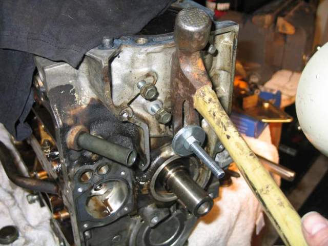

mr.radon Posted January 18, 2005 Author Share Posted January 18, 2005 The pins for # 3 & # 4 pistons come out the same way as #1 & #2. I'm wondering what is special about tool #499097300 The one they describ to pull the pins. How does it work? I;m sure this is the same tool the EA82 engines use. Where can I get one, how do you make one. I want to split the engine Thursday. Autosport in Seattle is machining my heads and reseating the valves (after they pressure test it) Let me know on the pin tool. I'd like to know the best way to get the pins out! Oil pump, got the seal, the pump itself checked out fine per the service manual. Lifters, 6 rebuilt ones on order. Thanks guys. Never realized I was a black sheep? Nah, I got a Gl SW too. Quote Link to comment Share on other sites More sharing options...
idosubaru Posted January 18, 2005 Share Posted January 18, 2005 i think that tool is really long in order to reach further into the engine. from the front and back, pistons 1, 5, 2, and 6 are accessible with short nosed tools. 3 and 4 i think need to be long and skinny to pass through the access holes to the center cylinders. i know someone in canada borrowed one from the dealer for a weekend. i'd guess most dealers probably don't even have it and wouldn't loan out tools like that. Quote Link to comment Share on other sites More sharing options...
Snowman Posted January 18, 2005 Share Posted January 18, 2005 I dunno if this would work for the ER27, but it's worth a shot. So far, I have avoided spending the money for an actual piston pin puller by making a substitute out of a bolt. I ground almost all of the head off so that it has a little nub sticking out on one side that can grab the pin and pull it out. You might be able to make a really long one that would reach way down in there. It works great on EA82's, but reaching that far might be problematic. Quote Link to comment Share on other sites More sharing options...
Tycho Posted January 18, 2005 Share Posted January 18, 2005 Here's how we got the pin in 2/4 out of our EG33... http://homepage.mac.com/dgiessel/.Pictures/misc/eg33/PB200055.JPG Just the bolt method as described by snowman...and some really Fing long needle nose pliers. Quote Link to comment Share on other sites More sharing options...

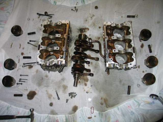

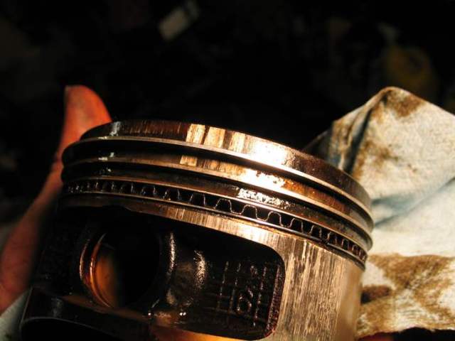

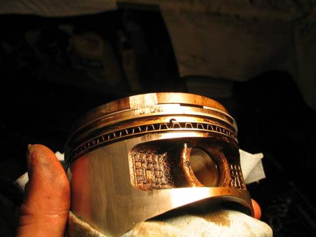

mr.radon Posted January 19, 2005 Author Share Posted January 19, 2005 Well I got the engine apart last night. I had no trouble pulling the pins. I got a 10" long 3/8" carraige bolt. I have a mill so I took of the square and made a sharp 90 degree prawl to grab the end of the pin. I had to later add a recess to get by the clip behind the pin. I used fender washers and a bolt to give me something to grab on. I added a flat spot on the end so I could tell where the prawl so when the tool was in the pin. On pins for #3 & #4 I had no trouble. I used a hammer claw to pry the pins out, these were the stiffest pins to pull. Problem is now that I have it stripped I found pistons #2 & #3 need to be replaced, they have small spots where the edge got seized or pasted onto the cylinder wall. The engine ran fine though, just aleaky head gasket. Quote Link to comment Share on other sites More sharing options...
