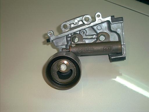

On most subaru engines that run a timing belt you will have 3 idler belt pulleys, and a tensioner assembly. the tensioner assembly consists of a tensioner and a adjuster. i took some time and labeled the 2.2 engine and its components so you could get a better grasp on whats behind those timing belt covers.
When i do a t/b job at my shop, i always spin the tensioner and pulleys to see if the bearing is holding up. it should spin smooth, not like the sound of a metal rollerskating wheel. that is the way you can tell if you need new ones. if you have any questions, please post. if you need a full size pic of the diagram, just email me, i had to shrink it to post it on here.
subarueast@yahoo.com
Nice, thanks for the pics! I moonlight as an engineer in a machine shop, work with bearings a lot, can those pulley bearings be replaced? Or are pulleys cheap enough it's not worth it? I could even make some new pulleys, but not the toothed one.

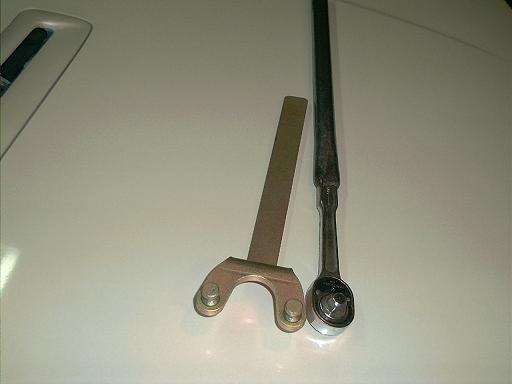

What's the pin spanner for, looks like crank pulley?
<<What's the pin spanner for, looks like crank pulley?>>
close, camshaft sprockets.
