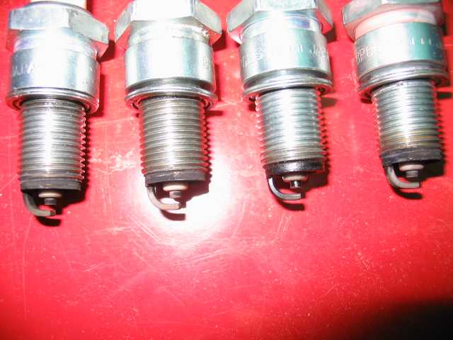

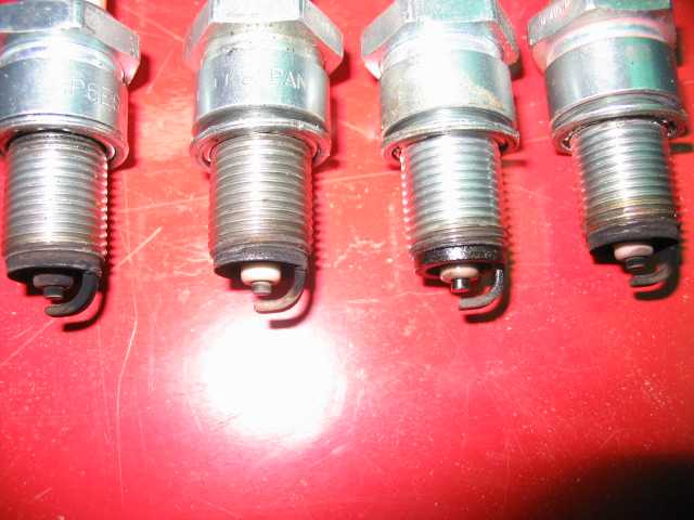

Just took the plugs out, done 50km so far - running very nicely overall.
The pics show them lined up from 1-4 left to right. #2 and #4 look quite normal - just a little brown colouring on the top.
#1 is rather sooty on one side in particular. Maybe a dripping injector?
#3 looks quite shiney on the insulator - like its wet. looks normal after wiping with a rag. :confused:

Spark plugs have cleared up nicely. Has burnt maybe 100ml of oil.
