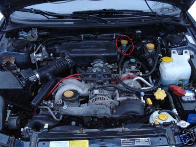

Hmm? there is nothing in the middle like in that photo. I looked at the clutch pedal and it seems to engage a spring with some levers attached to a cable the goes through the fire wall I think.
