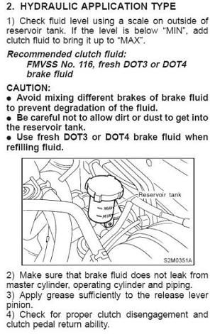

Before you shell out $500 for clutch, make sure there's no easy fix. Check fluid in clutch cylinder, check that there is some freeplay of clutch pedal.>>what do you mean by free play?
You should be able to push the pedal down at least a little ways before the hydraulic cylinders kick in to move the release fork. If you have no freeplay it could be that your clutch isn't having the full amount of force applied to it when you let off of the pedal. You should be able to tell when the master cylinder starts to pressurize the system when you push in the clutch pedal because there is more resistance.
where is the clutch cylinder? I just went to check. I have found the brake fluid reservoir. There is s small black cylinder between the brake fluid reservoir and the windshield washer fluid reservoir. however I don't know how to get it open. does the car have to be warm in order to accurately check it?

The cap should just unscrew. The car does not have to be warm.

what I've identified as the clutch cylinder does not appear to be a screw off cap. it has two or three hoses going into it. should that be the case?
