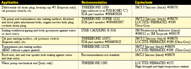

Thanks for all the info, it came right off with breaker bar and a pipe with one quick application of the starter. I had oil all over the front of the engine, seems the front crankshaft seal on the front of the oil pump was leaking, removed everything and got a new seal, now I have to put it all back together. Anyone know if Subaru recomends a particular sealant or can I use any high temp sealant for the pump?
Yes the recommend some three bond sealer I think it is which can be tough to find. The approved alternative is Permatex ultra grey, which you will find at nearly any auto parts store.
Don't use too much though; you don't want any little pieces to break off and get lodged in the system somewhere.
Also make sure the o-ring seats correctly and does not fall out as you put the new oil pump on.

anaerobic sealant is the proper sealant to use. it doesn't run the risk of coagulating in your oil supply if any happens to get in there. regular Permatex products and RTV that most people use will work, but it's more risky.
make sure it is a anaerobic sealer. Triple bond and permatex ultra grey are
i don't think this is true, permatex ultra grey is typically used, but it is NOT anaerobic. the anaerobic stuff is expensive and requires the applicator spray as well, but you don't need much of it, i'd stick to it. there's a picture on one of the XT6 groups of a guy who used permatex stuff and it got caught in his oil supply lines...i believe at the cams. he had severe ticking and found the glob of sealant wedged at the cam oil supply between the cam and the head, blocking oil supply to that cam. properly used it'll work, i'm not trying to sound like it's the end of the world, but don't be liberal with it if you're using the other stuff.
Since I have to go buy the selant I will make sure it is an anerobic sealant, to easy to risk gunking up or ruining the engine with a silicone based stuff.
Ultra Grey works fine, just cut the nozzle at the smallest opening, 1/16". If any chunks split off (unlikely considering how the bead forms on the outside), they will go straight into the filter. I wonder why the factory recommends Ultra Grey and not anaerobic sealant. Perhaps they don't trust service technicians to clean the surfaces well enough.
Subaru recommends some # three bond sealer in this app. Maybe that's an anaerobic. Ultra grey is an approved alternative. Maybe they know it's easy to find for us, probably like three bond is for them. Rather than recommend some alternative that is hard to find so people just use whatever they can get their hands on.
never seen the "applicator spray", but use the permatex anerobic stuff all the time from the red tube, and the sealant is red as well, smells sweet. Never had a leak, due to the sealant, that is....
