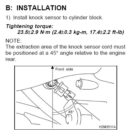

Knock sensor is $97 list or $70 something at a discount OEM parts seller. Very easy to change, but get the orientation and torque right. They like to crack if overtorqued. And like nipper said, check connections first.
