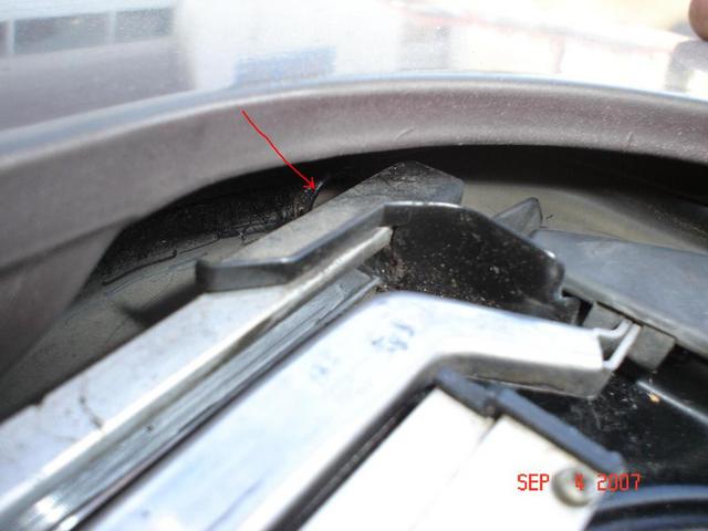

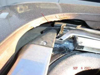

starkiller Posted September 4, 2007 Author Share Posted September 4, 2007 really need to see a pic of where those ^%^& drain holes are, especially the front ones, we had a big rain last night and the carpet on the passenger side is soaked i cant be having this as we are now in our rainy season and this is my dd Quote Link to comment Share on other sites More sharing options...
82glsw Posted September 4, 2007 Share Posted September 4, 2007 the drain holes are located in the very front corners of the sunroof and there also some in the very back of the sunroof. never had any problems with the rears one. when i had a leak i tryed clearing the drain hole and couldnt get anywhere so i pulled the part of the inner fender out where the drain tube run and found a large build up of dirt in there. cleaned it out and havent had a problem since. ill try to post a pic of the drain holes later today. Quote Link to comment Share on other sites More sharing options...
starkiller Posted September 4, 2007 Author Share Posted September 4, 2007 please do as i have opened the roof and tried to look from inside the car, outside looking in, took off the deflector to see if that would help, either i am really blind or they are covered up i thought they drained in back of the mudflap? Quote Link to comment Share on other sites More sharing options...
Gnuman Posted September 4, 2007 Share Posted September 4, 2007 please do as i have opened the roof and tried to look from inside the car, outside looking in, took off the deflector to see if that would help, either i am really blind or they are covered up i thought they drained in back of the mudflap? And have you seen how much crap collects back there? In a 93, the drain hose may even stick out of the rear of the fenderwell (the plastic piece that defines the inside of the wheelwell) towards the rear of the front wheels. If you have compressed air, and do not want to drop the headliner, you can blow the dirt out from the bottom. It will, of course, collect in the tray. One other point is that the drain hoses sometimes come loose from the tray, causing the tray to drain right onto the headliner. Your best bet at this point is to drop the headliner and inspect before trying to fix a situation you are not sure of the nature of. Quote Link to comment Share on other sites More sharing options...
82glsw Posted September 5, 2007 Share Posted September 5, 2007 both pictures are the front drain holes i actually couldnt find the rear ones myself. one pictures is the left one is the right Quote Link to comment Share on other sites More sharing options...
