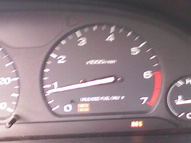

ok...i replaced the IAC today ( didnt use a new gasket) as soon as i started it up the idle went to like 2500 and didnt move also got a CEL code 505.....so obviously the other IAC didnt work.....it seemed pretty gunky in the vacuum lines around the IAC so i cleaned them out and put the old IAC back on.....it seems to idle a little higher.....i have a photo here and was wondering if anyone can tell me exactly what is a normal idle on a 1996 subaru legacy L 2.2....Also i have a digital volt ohm meter with a Tach. function.....does anyone know how to hook that up so i can properly read the engine RPM.....
