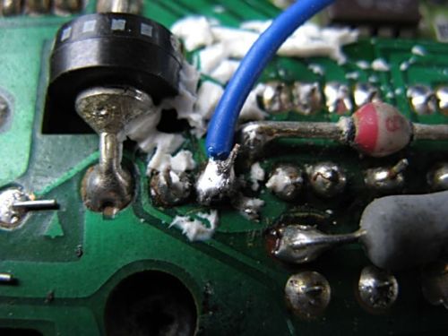

Here is the pic of the mod to the MAF. I am using a 100 ohm potentiometer and right now (with stock injectors) it is at 60.5 ohms.
You can see the cut trace in the upper right corner.

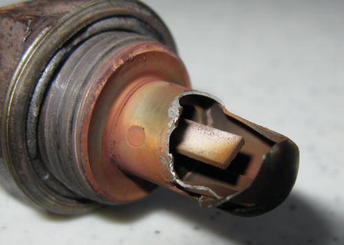

Ok I found in a catalog on the internet that my sensor is a Titania one. It looks like only the California turbo models had it, which my car is. I found a new sensor on sparkplugs.com for $59 so I ordered it.
Put the new o2 sensor in this morning, it's definitely a Titania one. The Titania use a flat strip instead of a cone shape. Attached is a pic of the old sensor, I cut it open.

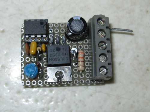

I made up a little circuit to send a PWM signal to the wastegate duty solenoid, for more boost. It has a dummy load resistor so the ECU does not throw a code. The original signal from the ECU is a 20 us pulse at 15 Hz, basically 0% duty. However with this short pulse it can detect if the solenoid is plugged in and throw a code if not. I read somewhere that the ECU will up the boost at high altitude with this signal, but I am at sea level. A 50% duty is giving me about 10 PSI.

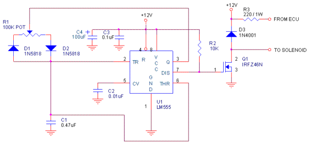

Can you give some details on this circuit, im very interested.
Here is the schematic. It is basically a 555 timer that generates a variable duty cycle PWM signal. The frequency is around 15 Hz.
It works pretty good. On shifting (automatic) I get maybe 1 PSI spike. It holds boost to redline; it's way better than the MBC I tried.

One thing has me puzzled though, this boost solinoid is constantly opening and closing right? don't you think this will fail shortly if you keep running it like this? it was not designed to work like this for prolonged periods right?
it IS looking really good indeed, good job
Yeah, you might be right. I thought about that before as my solenoid is clicking away at idle; it's not that loud though. My thought was to connect my circuit to the "Boost" light on the dash, so it is only working under boost, but I haven't got around to that.
edit: I attached the ground of my circuit to the boost switch, now the solenoid only acts under boost. :)
