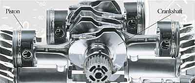

<<Not sure about the synthetic coated pistons, then again it's what my Subie dealer uses.>>
what are you talking about?:confused:
The black part on the piston below the rings is a synthetic coating.
Not sure what year subaru started doing it, but my o6 has it.
http://forums.nasioc.com/forums/showthread.php?t=907570
Piston Coatings
Dry film lubricants, also known as solid film lubricants, provide a lubricating film that reduces friction, inhibits galling and seizing, reduces piston scuffing, extends cylinder bore life, and in some instances can aid in dispersing heat. One of the obvious reasons for using a lubricating coating is to reduce friction, which improves wear, extends part life, and frees up power normally lost due to friction. A second major benefit is a reduction in part temperature. As well, no machining is 100% perfect, so the coating will wear and make up for very slight differences decreasing blow by.
Most dry film lubricants are Molybdenum Disulfide based. Why not Teflon? PTFE, also known as Teflon, is listed as having the lowest coefficient of friction (COE). However, under high speed and load, the COE of PTFE degrades while that of MOS2 (Molybdenum Disulfide) improves, until it is significantly better than PTFE. Moly also attracts oil, keeping an adequate film on the part unlike PTFE, which sheds oil.
Dry film lubricants are primarily applied to piston skirts.
