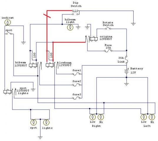

April 1, 200917 yr Author ... Here's a circuit diagram of my headlight wiring, now modified with relays. I've drawn a red line on the Low beam's negative. Now if that switch that turns to high beam and low beam wire is no longer connected (I've confirmed the dip switch does break the circuit 100%). Surely there is no way the coil on the relay can have power if that negative through the dip switch is broken (keep in mind the original wiring no longer goes to the headlights)?
April 1, 200917 yr If your diagram is correct,the high beam relay coil is grounding through the indicator bulb w/the dip switch in the low beam position. Also,the indicator won`t light in the high beam position as there is a direct path to ground through the dip switch. Did you really rewire everything?Looks much different than stock.

April 1, 200917 yr Author The headlights are common positive. So keeping that in mind, you cannot run the low beam and high beam light through a relay to ground. I've just run them to the original headlights positive. My headlights are now common negative, and the relays "30" is connected to positive. Just like the diagram shows. Basically, right next to the battery I cut into the loom. I cut the four headlight wires, R RL RW RB. I then connected R and RB through 85 and 86 one and RL, RW on the other. Then the headlight side of RB went on the first relays 87 and the RW went on the second relays 87. The headlight side of R and RL (originally the common positive for the headlights) then went to ground on the battery. I added some wires from battery to a fuse box then onto the relays 30's. So only added wires were the fused 30's and extension for the R RL off the headlight to the battery negative. Of cause I also added the spot lights in which have a switch in the cabin that lights up when the spotties are on, so this needed to be wired like it is in the diagram for the light to work in that switch. The require two wires going from the spotties relay to that switch and some grounding wires. Heres a stock diagram I setup
April 1, 200917 yr Naru is correct. You need to move the indicator lamp lead to the other side of the relay coil and the ground side of the lamp will run through the swtich.

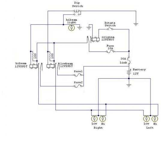

April 2, 200917 yr I see you changed the drawing. The way you now show it the low beams should work ok when the dip switch makes the ground connection for the low beams. As a note, I assume you have checked the current rating for the dip switch and it can handle the current load for both of the lights. The indicator light for the high beams is still not connected correctly. You have a common power lead to the lights and though you may have the low beams selected there is still going to be current flow through the high beams because the indicator light makes a path to ground for them. You need to connect that light in parallel with the high beams so no ground is made until the dip switch is turned on.

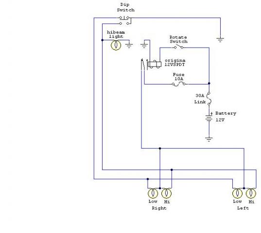

April 3, 200917 yr Author I didn't change the drawing..... Just ignore the spot light wiring because I have the same problem without all that wiring. I posted a standard wiring diagram, and also my modified one which is above (the first one I posted). Oh, and BTW the "dip switch" is what I call the original high low beam selecting switch the all cars come with that is on the steering column. It is rated for BLOODY high amperage. And all it is doing now is switching a relay that needs little more then 50mA. So heres a diagram without the spot lights...
April 3, 200917 yr You still have the high beam indicator light connected wrong. Current will run through the high beam relay coil and the light when the dip switch is on the low beam selection and when on the high beam the dip switch will bypass the light to ground. Just tie that light to one of the leads of one of the high beam lights and it will work ok.
April 3, 200917 yr Author ....... That is how the high beam is wired standard, I did not wire it like that. I know that is where some leaking current can come from but I do not understand how the low beam wire has the same voltage and current as it has no light, nothing, attached to it in the diagram. Please read But it still bugs me I can't find where this power is coming form. On the high beam it makes a little sense because the high beam light is earthed on one end, and because the headlights are common positive this could let power be drawn through the headlight and the dash light to feed that relay. But on the low beam it should be a straight wire from the dip switch to the headlights. My manual says it doesn't go anywhere else. But I'm not willing to open up the entire loom to find where this wire goes and where this power could be coming from. I want to ignore the highbeam for now (like I tried to make clear in all my other posts) because it is not related to the low beam wire having 6v when it shouldn't
April 4, 200917 yr I'm not sure where you are testing the voltage at and what you are using to test with. I assume you are looking at the ground side of the light with the circuit open. You may not have a high impedance voltmeter and your test equipment is loading the circuit and causes an error in the reading. A digital meter should not have this problem. Edited April 4, 200917 yr by Cougar
April 4, 200917 yr Author Ok, found the it. Sorry for discrediting your high beam light theory. My manual doesn't show this, but the high beam light is actually connected between the high and low beam wires from the switch to the headlights. So when your on high beam the indicator light is connected to ground through the high beam wire and to positive through the low beam wire through the low bead filament through the original headlight relays. Man do they want it to be confusing when making these cars. Would of made sense if my manual didn't show the low beam wire going from the switch to the low beam filaments without any interruption.
