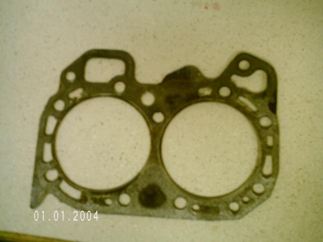

May 9, 200916 yr Author I think I might go with the RTV sealer then. I have a picture but its kinda crappy But if you look on the left side the gasket around the cylinder is mostly gone compared to the right side. I dont know if it's a good Idea but a gasket set is a lot cheaper on ebay then like autozone would it be bad to shop on ebay?
May 9, 200916 yr I haven't had much experience with anything other than OEM and FelPro. However, general sentiment is that when it comes to the intake gaskets, do NOT go cheap. Most seem to prefer genuine Subaru OE intake gaskets, others think that FelPro are OK. Offbrands don't seem to seal well, and you end up with coolant sucked into the intake tract, possibly blowing out the HG.

May 10, 200916 yr I still have never heard of an EA82 HG leaking coolant externally. not an EA82 - but similar engine in many ways - i had an XT6 that ran and drove perfectly fine, never overheated, and had a very slow seap at the rear of the engine. very much like the newer Phase II EJ25 head gasket leaks. i replaced those and it was good to go.
