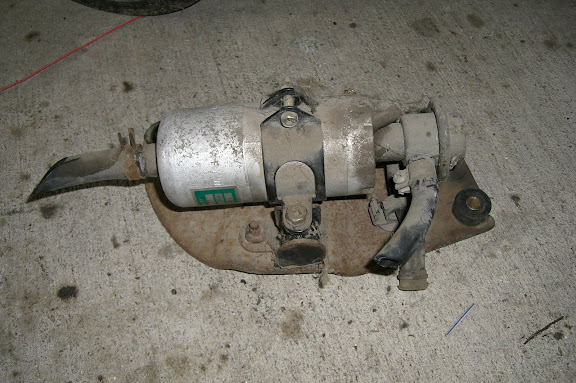

Fuel pump from turbo fuel injected Loyale

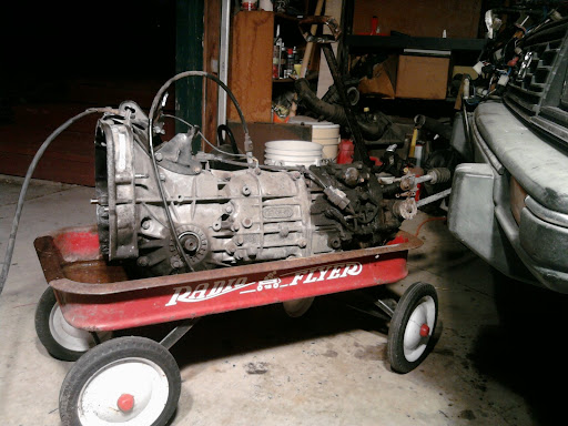

The legacy transmission (held up by radio flyer, been in my family for as long as I can remember)
Transmissions. Appearing from left to right: GL 5sp d/r, Legacy 5sp, Brat 4sp d/r. Note the size differences, the brat trans is 10" longer than the soon to be swapped in GL trans. That means the Legacy driveshaft will be shortened to fit in there. Yay for more projects!! More pictures and random writings to come as things get pieced together. Maybe one day I will be able to post a picture of my brat out on at least the road, hopefully a dirt one.
