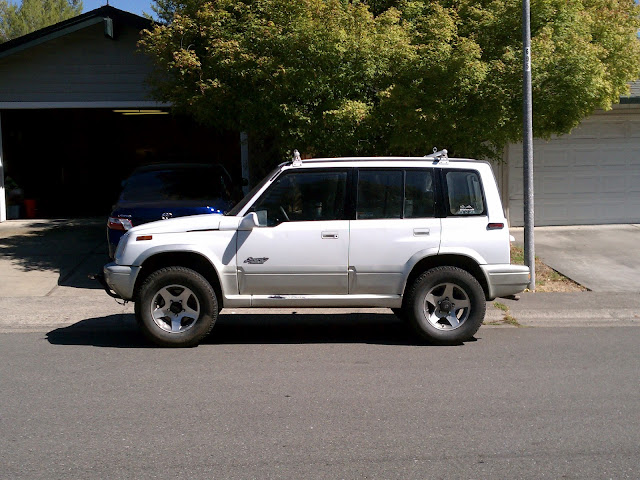

Just for refference, here is a friend of mines Suzuki Sidekick, we just installed a 2" lift on it today.
Its got a solid rear, 1.8 EFI, and apparently quite a few bits and pieces from Samurai and Toyotas can be made to fit.
Posted Image
Thats with 30" tires.
