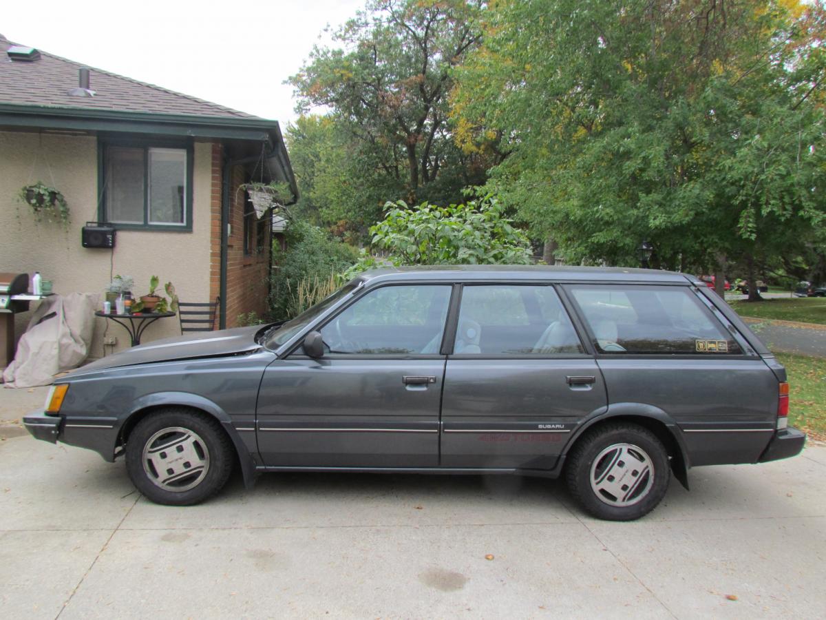

So I'm in the process of doing a Shakotan build on my GL-10, Its 4WD and the lowest I've been able to get it so far is about an inch lower than my CRX's stock ride height. I feel like I'm fighting Goliath here trying to get this down, does anyone have documentation of a 4WD Loyale or GL slammed? I've personally seen it on a FWD one, it was scraping the frame, but never on a 4WD so far.
My setup currently is:
XT front struts stock wagon springs
Stock struts in back with CRX coilover sleeves in back all the way down.
I have a pic of where it sits now. What am I doing wrong? lol I got a winter and a blown head gasket so I got time to sort this stance out. I also have some NB Miata rear struts I can pop in but need to get another set of coilover sleeves that will fit on them.

Have you inverted the rear strut mount bracket? I've read its worth about an inch.
and I gather you're not a fan of cutting springs? Even if you experiment with the stocks, OEM replacements are still available.

You can really get down there. Technically you don't even need coilovers in the rear, any 2.5" diameter circle track spring at about 8" will get you tucked just right on the stock shocks. Flipping the rear mount with the BFH clearance method gets you an inch or so while retaining your travel so that is worth doing...I am going to run GC Impreza front lowering springs and generic rears on my XT. Should have it ready soon (wheel bearings coming first).

Flipping the rear mount with a Big effing hammer? how?
I used coilovers off a CRX so I dont need to cut, mine are already about 8" tall, including the last .25" on the sleeve. Taking out the sleeve will net me another 1.25" drop, what all do you got for your set up?

You flip the rear strut mount, then use a BFH IF the strut fouls any of the guard with the top mount inverted.
I'm sure you'll get more than an inch out of inverting that mount.  You'll need spring compressors to do the job...

Flipping the mount you need clearance directly above the shock.  Where the shock nut/washer/rubber are on top.  I
Used a big punch hit with the hammer to keep the bashing centered where it was needed.   There is a hole in the layers of sheet stamping right where it needs to be just punch that up 1/2" or so.

Take item #12 in the following picture off the strut assembly, flip it, reinstall on strut. Simple.
Use spring/strut compressors, obviously.

yes I am doing that. Mine is a GL-10 AWD Turbo with rear disc brakes. Are you trying to raise or lower it?
