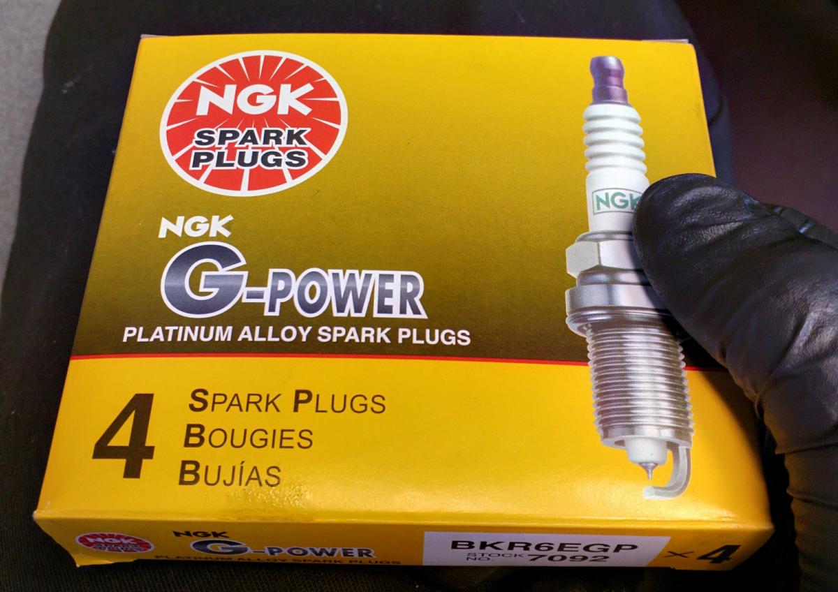

So everyone says use ONLY NGK Spark plugs. I replaced my plugs about 15K miles ago w/autolite coppers.
Been wondering why I get such crappy mileage and have done ALL the normal tuneup stuff. So i resolved to replace the plugs again w/NGKs.
So tell me if these platinum NGKs are the right ones please. I didn't wanna go with the iridium ones and didn't wanna use the base coppers. So i got these. Will it maybe improve my fuel economy?
By the way I have had no CELs.
If this doesn't then I will do the MSD coil mod.
I've been using the NGK platinum plugs, no problems there.

If you want to use platinum, For waste spark systems you need to use NGK Laser double platinum. Single platinum plugs wear too quickly and will cause misfires on one bank.

YES, YES, YES on the correct NGK plug
