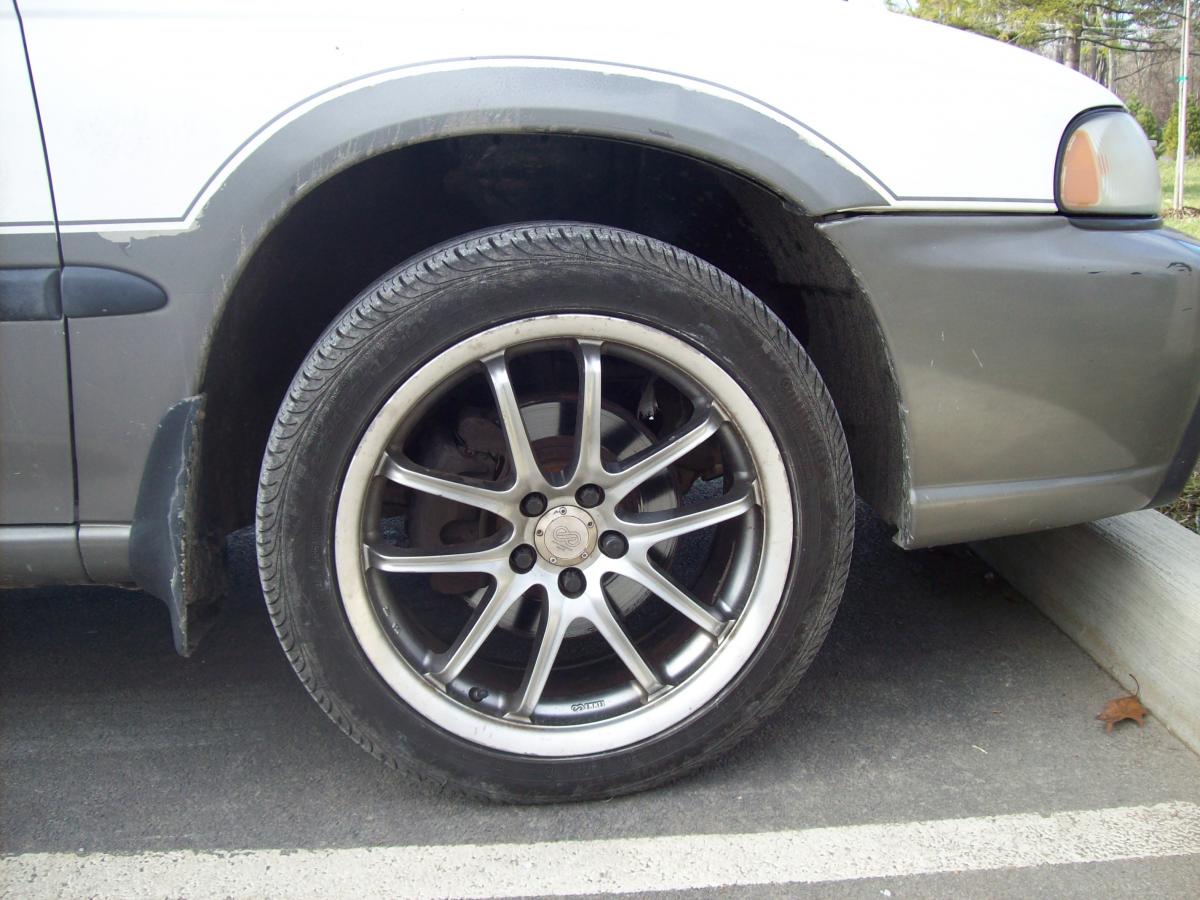

sirtokesalot Posted February 11, 2018 Author Share Posted February 11, 2018 this is how 205 55 r16's fit i think there's too big of a gap in the wheel well. Quote Link to comment Share on other sites More sharing options...
msmithmmx Posted February 11, 2018 Share Posted February 11, 2018 this is how 205 55 r16's fit i think there's too big of a gap in the wheel well. I am running 205/55/16 for summer tires. I agree they do not fill out the wheel well at all. Post some pics when you get this done. I am looking for a better fit as well. Quote Link to comment Share on other sites More sharing options...

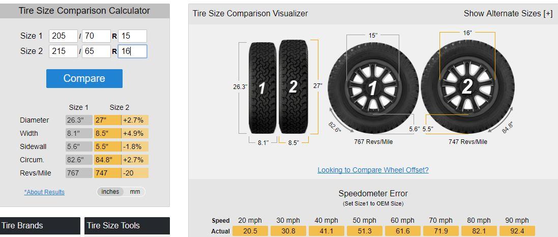

wtdash Posted February 12, 2018 Share Posted February 12, 2018 Ok....so covered somewhere(s) on here. Stock: 205/70R15 = 26.3" tall / height Opt. 1: 215/65R16 = 27.0" tall / height See attached. Should be no fitment issues other than possible rubbing on the front inner wheel wells at full lock. Quote Link to comment Share on other sites More sharing options...

sirtokesalot Posted April 24, 2018 Author Share Posted April 24, 2018 (edited) update i put the tires on today they get really close to the mud flaps and i think might rub the passenger one under the right circumstances witch i think i could fix if i just put an extra screw in it because that mud flap is loose. but they fit. heres a few pictures of how it looks now with the bigger tires. downside is the speedo is off 5 mph when the gauge says 50 its really doing 55 on gps. these are the 215 65 r16 and heres a before with 205 55 r16 Edited April 24, 2018 by sirtokesalot Quote Link to comment Share on other sites More sharing options...
