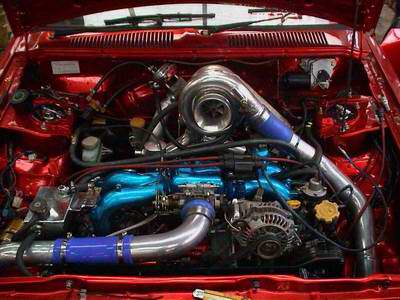

78TurboBrat Posted October 29, 2003 Author Share Posted October 29, 2003 Tom to answer your question i am using the 89 wagons master cylinder, and yes as you can see, it is very tight clearance between the disty and the master cylinder. was going to use a ford probe one which was 1/2 inch shorter but the lines didnt line up the way i needed them to. if you find something that works better, let me know, the booster was also changed. from the wagon to the brat. but still have the old ones, of course the master that came off that car was toast along time ago. good luck.... Quote Link to comment Share on other sites More sharing options...
MilesFox Posted October 29, 2003 Share Posted October 29, 2003 my trashwagon is an 83, it has the brake booster and master cylinder off an 82, which has 2 reservoirs, which is the same unit in pre82 gen 1's. so you got the whole brake booster off an ea82, if i read correctly. from what i have messed with, i have noticed the pedal boxes for ea81 and ea82 bolt up to the firewall the same, and of course, the brake booster studs go thru these holes. so what is in the turbo brat for a transmission?, and where can i find the pics? milesfox@yahoo.com Quote Link to comment Share on other sites More sharing options...
78TurboBrat Posted October 30, 2003 Author Share Posted October 30, 2003 http://usmb.net/gallery/albuo84 the above url is to the brat pictures. there are two pages to it. the brake setup was quite simple it just bolted in, and if i remember correctly i had to move one or two holes, cause the older was offset, and the wagon was a sqaure pattern. the transmission is the one from the wagon, a 4wd unit 5 speed Quote Link to comment Share on other sites More sharing options...

78TurboBrat Posted July 20, 2004 Author Share Posted July 20, 2004 Well time to update the thread as more work has been done. Had the old cracked dash taken to a place and had them fiberglass the dash. what a nice job too. looks really good, but the only draw back to it , is that it is now smooth. was thinking of putting something on it like a rhino liner, but with smaller particles so that it wouldnt be so rough. any ideas on this one. Custom axels cost $85.00 a peice. and its a one peice axel with the correct ea82 on one end and ea71 for the brat on the other end. Custom 3 core radiator made with from the form of the stock brat radiator to fit in the stock place. Sand blasted bed area, rhino lined. Trim on side of car removed, holes brazed up, and ground smooth after giving the holes a beveled type edge to hold the braze. Transmission mount reworked to give better support. Couple of joints to make the steering colum clear the axels. although lifting the brat would fix the problem too. Pulled the wiring harness and ran more tape around the wires, then wire loomed them after extending some wires. Gave the front wheels some new bearings to ride on as the car sat for over 20 years. Boiled the gastank, ran new 5/16 inch steel lines from front to back with compression fittings at the tank with a 6 inch peice of flex line. and so many more little things like gauge cutouts in the dash for water, temp and oil. Boost not really needed as i dont really plan on pushing much more than stock as i dont think the car will hook up well with out some 40's on the back. or a ton of concrete in the bed. Will post some updated pics of it soon. Just really busy working and trying to get things together between this project and another one which is a 87 chrysler conquest with a 5.0 mated to a 5 speed done in time to go to new york. Quote Link to comment Share on other sites More sharing options...

Matty B Posted July 22, 2004 Share Posted July 22, 2004 Well done with the Brat mate, well thought out and nicely converted. I bet you are looking forward to 4WD when those fronts come onto line. How does it handle with the rears only driving it? You must get some amazed looks when the back steps out with some drift! Cheeers. Quote Link to comment Share on other sites More sharing options...
78TurboBrat Posted July 22, 2004 Author Share Posted July 22, 2004 it was quite squirly at first, but now that i have the 4wd working it is quite an eye full to see an old car like that do something like a 4wd burn out. and take mustangs and so on. quite fun to drive. Quote Link to comment Share on other sites More sharing options...
