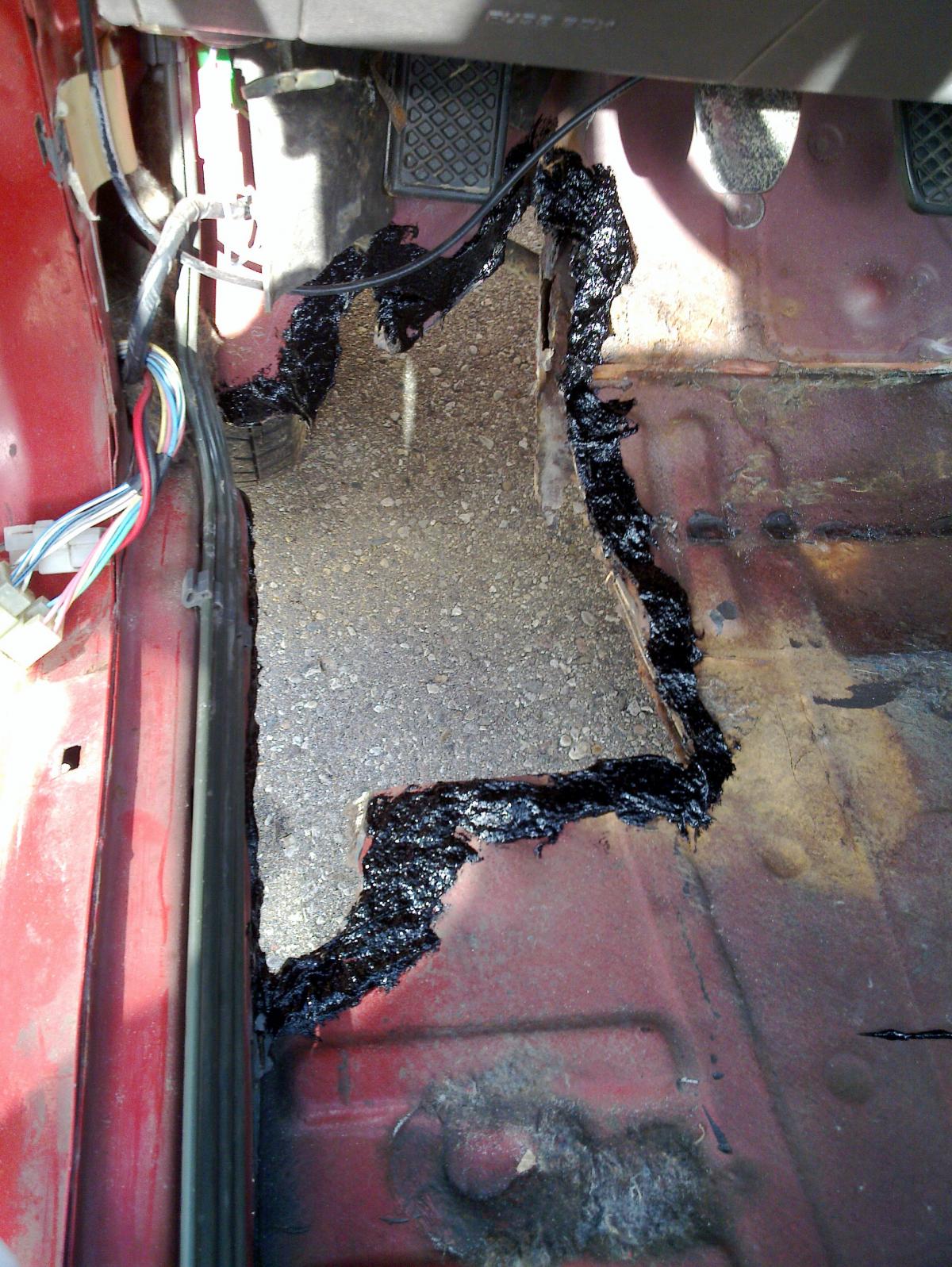

took out the seats today, along with alot of trim and the carpet. Found what I was looking for..... RUST!

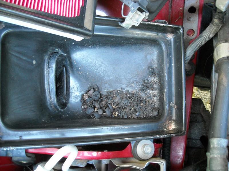

Continuing on with post-sitting-for-a-year maintenance, drained/refilled the power steering reservoir, removed coolant overflow tank for a soaking with Simple Green (twas nasty inside; full coolant flush shortly). And though my air filter itself was rather sparkly clean despite a year of use in dusty Colorado and then the dusty trip to Florida, found this when I pulled it out of the air box:
..damn squirrels.

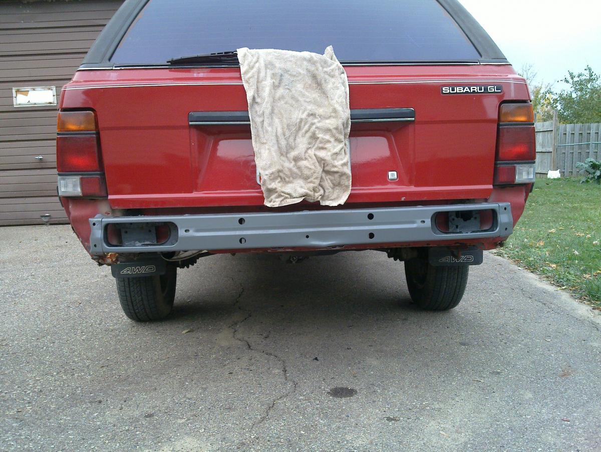

added a 1987 300zx front bumper to the rear of my 1989 suburu GL. Will add the bumper cover soon!

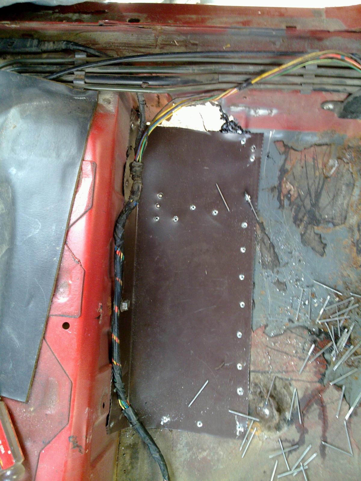

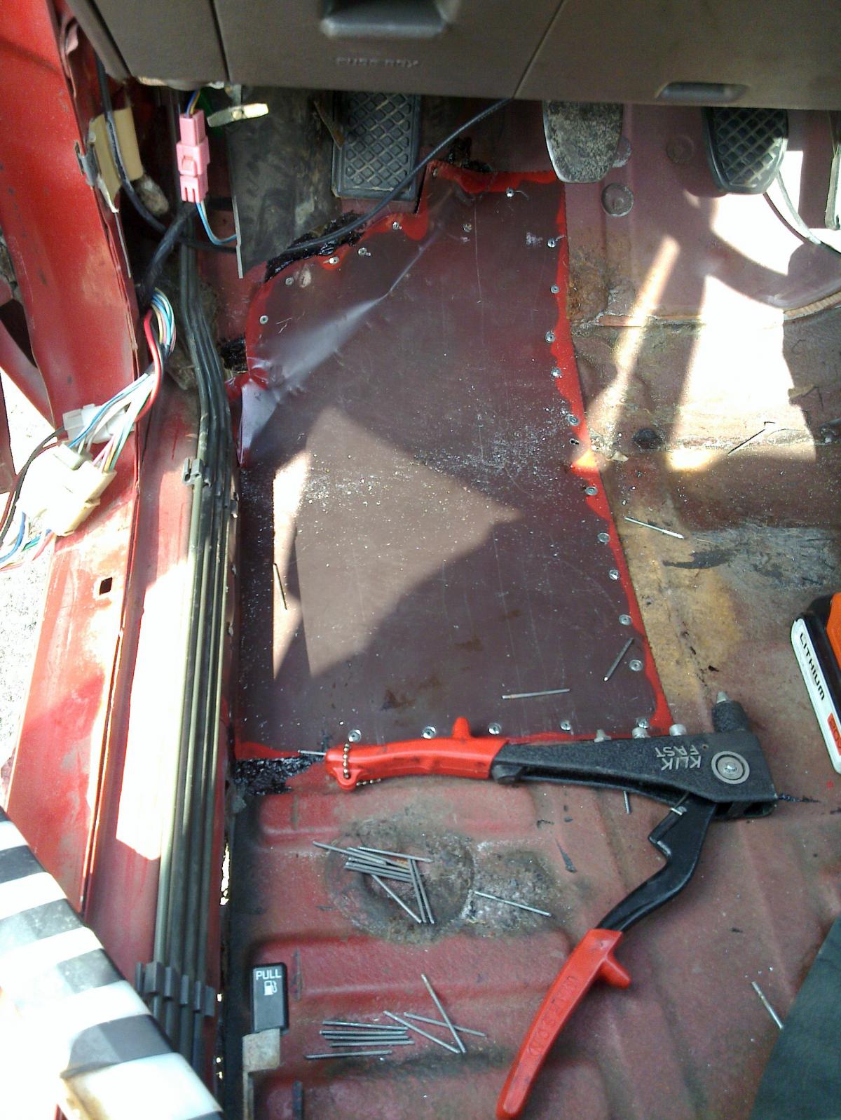

Pop riveted some sheet metal to cover up the giant rust holes! that is roofing tar I used for a seal. Next fiber glassing!
