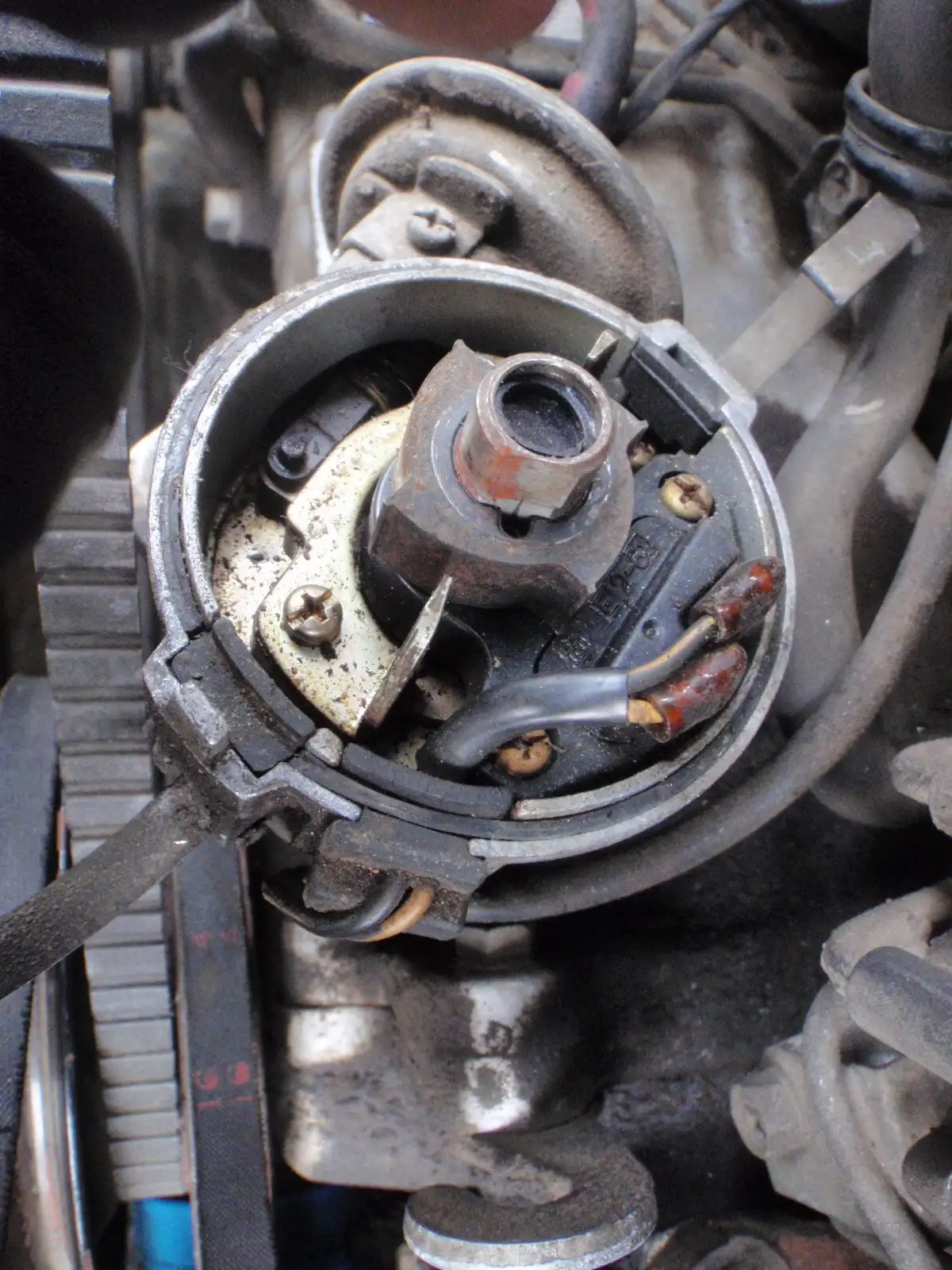

Went to get a pic... but the Hitachi dist in my '83 wagon is completely different. I found this googling, and it has a pic that should do it: https://ausubaru.com.au/viewtopic.php?t=21289 Black with white is positive, yellow is switched / coil negative / tach /etc. - Today

Ignition timing advance from the weights expanding etc inside the distributor. But yes there’s also the difference of the vacuum ports. What I’m getting at is folks had appreciated that ignition curve advance from the different distributor. Wish I had that crisp memory of which and why but maybe the archives might hold some info. But just reverting to stock it won’t mean much. There might be wiring diagrams online. Or they’re definitely in the back of all factory service manuals. I sold off my 80s but they’re cheap enough usually. -

According to the shop manual all the 4wd soobs had the Hitachi in 83. I did notice the curve in the Nippondenso vacuum advance arm. It is straight on the Hitachi. I don't know what difference that would make but when mine starts dogging out and loses all spark at 2500 or so RPM, it does sound like the vacuum advance is not working properly. That was the first thing I checked but it seemed to be ok. I am hoping once I figure out this wiring the Hitachi will solve the problem. -

Maybe swapped for the advance curve. That was a bit of a thing to do for some. I’m not positive that applies to yours but i seem to recall the automatics had a better advance curve and maybe FWD different from 4wd ? I would have to check a parts manual. But that was my only thought on why they swapped it out. My 79 4wd wagon was swapped out with a FWD complete engine and exhaust. So i had to decipher that at one point due to ignition parts. Same deal it’s Hitachi or ND. Good luck with it. -

Thank you sir, no hurry. The wiring was cut and spliced when the original Hitachi was replaced with the Nippendenso. Thanks again, Bill
