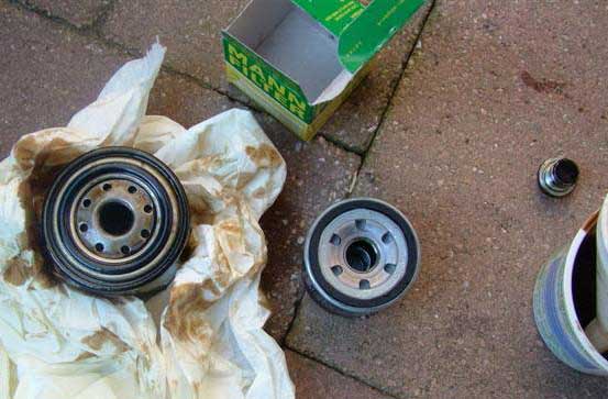

  5. I took of the old filter and fitted the tiny new one after checking with an other car parts store. System is a bit different here than US. There are not so many parts stores and Wal-mart where you can buy simple car parts. Service intervals are every 12,500 km (about 7500 miles) much more than over there. THink it will run fine, will see.
  6. Going to replace oil this weekend and got new oil filter: MANN filter W67/1, its hard to get hold on subaru filters and MANN seems to be pretty good from some filter reviews in europe (largest surface). However this filter looks so small. Sizes are 2.6 inch wide, hight is about the same and bolt size is M20 1.5 all these numbers seem right to me. Guess they just get small these days.
