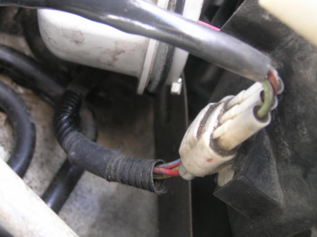

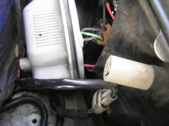

02' Legacy GT - headlights wiring
740gle replied to 740gle's topic in 1990 to Present Legacy, Impreza, Outback, Forester, Baja, WRX&WrxSTI, SVXI just ordered replacement harness from Liberty Subaru. Another option would be to re-crimp new connector that goes on the bulb, not sure if I could find a new one. It goes on the H3 that is used for low-beams and DRL. I think 95' is different design. Of all the car, I guess the headlights are specifically designed to US spec - and they are absolutely horrible. While the rest of the wiring in the car is in a fairly nice shape so far, the headlight wiring is clearly under-specified the insulation started crumbling and melting away after about a year into cars life.
740gle replied to 740gle's topic in 1990 to Present Legacy, Impreza, Outback, Forester, Baja, WRX&WrxSTI, SVXI've managed to find that magic tab and disconnect the part from the bottom, but in order to replace the headlight harness I'd need to take out the top part, and it is fastened to the black plastic wall. I pried it a bit, it loosened but did not come out. Before I do more damage - is there a magic trick of taking it out, or is it just supposed to be forced out and get disposed and is replaced as part of the new headlight harness?
740gle replied to 740gle's topic in 1990 to Present Legacy, Impreza, Outback, Forester, Baja, WRX&WrxSTI, SVXThanks for the advice guys, if there is a way to replace it, I'd rather try it, do you remember what is the official name of that harness? I tried to pull the top up, I'll try to pull the bottom part out. There is indeed something that may be a "tab" on this connector, it's a bit cruddy there, does this tab just have to be pushed in from the outside, or pried out with a screwdriver? I was thinking of crimping, not soldering. I know how to solder, but I am not very good at it. I can get a good crimper at work, but I'd have to take the wiring out. I am familiar with liquid tape, had to deal with it applied by the previous owner on my old Volvo... It's a good product, but leaves a mess, as you mentioned - once you open the jar, if it's not used - it's a waste. I'd rather like a shrink tubing, you just have to make sure that the right size is used. -Michael
They do go out intermittently, one at a time. Just re-plugging the bulb, or sometimes even a gentle wack on the headlight brings it back. The crimped connector to the bulb is crappy - insulation is crumbled, oxidation, etc.. Contact cleaner brings some temporary relief, but it's obvious that piece of a wiring harness, or at least the bulb plug has to be replaced. How can I take that harness piece out? There is a white plastic thingy, that holds harness to the body, and looks like a connector (see pics attached), but I cannot figure out how to disconnect it. Any help is greatly appreciated... -Michael
