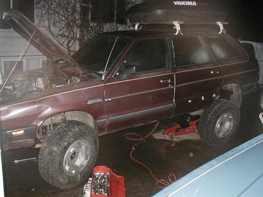

  3. ok here are a couple pics, more later when I get it back together(and driving around the block... enjoy :-) oh yeah, these are the tires that came with the rims, they are 31x10.50x15s, they are a perfect fit, I'm pretty sure if I wanted to I could fit 33x11.50x15s pretty easy, but I think I'm gonna go with some 31 inch bfgs or swampers.

  8. hey sorry.. I had trouble wrestling with my exhaust last night, I dont want to take any pictures untill I've at least driven it around the block. camber up front is still pretty bad lol

  11. okay, so after about 3 weeks of sitting while I've been getting my lift on there, I got all the hoses taken care off, still trying to get off old stuck brake lines(correct size flare wrench rounded off the nut, and now I cant get the wrench off, can you believe that?). anyways the parking brake works fine at least. the one major thing I overlooked, is the wire that goes from the ignition switch to the starter solenoid/relay whatever, isnt long enough so when I dropped the engine 6" it disconnected and I wasted about half an hour trying to figure out why the thing wouldnt turn over. anyways, havent driven it around the block yet, will shortly. the camber is still all messed up, but we'll see what it looks like once I drive it a little bit, also I got a bit too much toe in also, so that leads me to believe that it will be fine once my suspension settles a little bit. not gonna worry too much about it untill I get new tires. pics tonight... soooo psyched about this...
