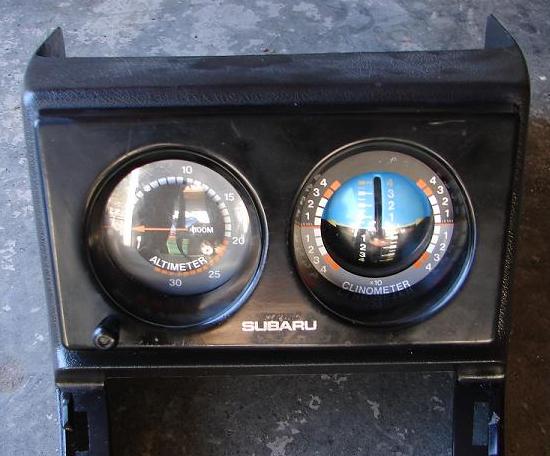

  7. Hey team, I found this on a wrecked 87ish subbie wagon that a mate had, it looks factory to me? I wasn't aware these came factory, can anyone confirm this? The "subaru" isn't a sticker either, it's etched on and it was screwed/fitted into the center console of a Auto wagon, a perfect fit. It all works and so forth, but the fluid was a little low on the inclinometer, so i thought i would top it up, looks like a light oil of some kind, any ideas on what exactly it would be?

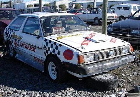

  8. Hey guys and gals, well i've finally found the vehicle to complete my collection! Man have i been searching for ages, these are NOT a common car in New Zealand! A 1983 4WD hatch A few panels are dented, but very little rust and an excellent runner. The underside is the cleanest i've ever seen on a 1983 car... bloody good deal for $50! It'll go nicely with my 1983 Brumby ute and 1983 Twin Carb RX coupe. It'll be receiving a complete strip down, a bit of panel beating/paint job, a 6 inch lift ,a EJ22 / AWD D/R gearbox, Six stud conversion for the 29" tires plus a few other odds and ends i have sitting around the workshop waiting for a vehicle. You can see i've already removed the front bumper and most of the interior is now gone. I've got a fibreglass bonnet and front fenders lined up as well. I thought this would be a perfect car to remove the front radiator and place it above the engine like "subarubrat" did on his ute, in order to improve the front angles. Anyway, i'll be posting pics of the progress for sure! John.

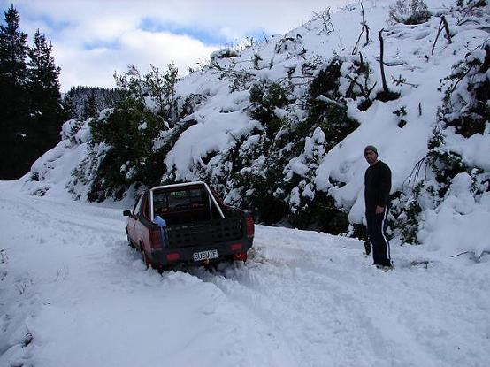

  13. I thought i would add one more pic, i must admit we were stuck at this stage and sliding towards a rather steep bank. The brumby just didn't have enough weight to bite through to the gravel. A little digging and we were away... but perhaps i should have had chains on.. hehehehe:grin:

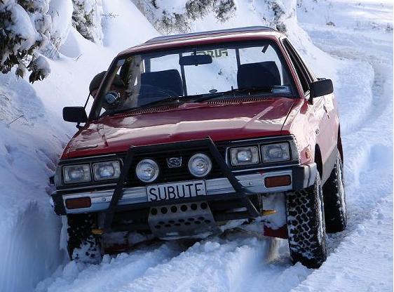

  14. Hey guys, I'm wondering if the other kiwi's in this forum got out into the snow we've been having recently? got any cool pics? I know a lot of the USA members live with this every year, but this is a lot of snow for New Zealand!

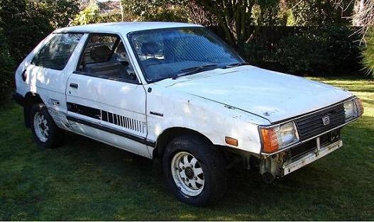

  20. Damn, i was worried the doors would be different...

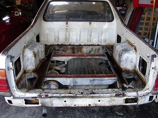

  22. I started pulling it apart today, The only real rust i found was in the back tray, so I decided to remove the back tray and it'll be replaced with Aluminum diamond tread plate. See attached photo. The engine started up staight away, after a check of the oil and filters etc. It runs really nicely and has the electronic distributor, SWEET. The under body is in excellent condition, as are most panels, it's been rust proofed from new i think, so it's really paid off now! I wee trip to the panel beaters will freshen it up and give it a fresh coat of paint and redo the graphics, bumpers etc. nice I'll be replacing the interior with good condition panels and leather Legacy seats, plus a legacy Momo steering wheel. I'll have to install sounds as well, Just a CD/MP3 head unit, 2 way components in the doors and a 6X9 sub behind the passenger seat. I'll then be fitting a 5 speed D/R and rear disks, then putting it back on the road. It's in too go a nic to convert to a dedicated off roader, so I'll keep looking for a donor vehicle for that project. I'll post more pics when i have them.
