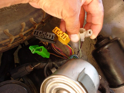

I don't know about the '85 ...but I have a '90 with some plastic connectors - green and white. The manual tell you which ones ... Folks - don't let me steer this person wrong if my Soob is way different. I can just hear it now: "Davalos, you $#&%#, my car caught on fire!!"
