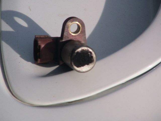

The Dreaded Misfire Saga Continues
subsince77 replied to subsince77's topic in 1990 to Present Legacy, Impreza, Outback, Forester, Baja, WRX&WrxSTI, SVXThe little black plastic mounting bracket for my radio antenna is cracked a little - could it be leaking a small amount of electrical pulse that is traveling into the car and tricking the ECU into thinking it is hearing a misfire? Hey, seriously, this is sad, but I know I have read that there were some ECUs in this vintage that had problems. Yes, I did already replace the ECU with another used one, would there be any point in throwing another one at it? Probably not. I was thinking about the rest of the wiring that runs through the firewall too. I have no motivation to even think about attacking that now. The car runs SO WELL! We drove about 60 miles today doing some X/C skiing. It purrs like a kitten. Actually, for some reason, with the new intake it even idles smoother - my wife even noticed it. Ya just have to ignore the light. Thanks for the interest everybody.
subsince77 replied to subsince77's topic in 1990 to Present Legacy, Impreza, Outback, Forester, Baja, WRX&WrxSTI, SVXPlugs and wires? Maybe I should try that:grin: Sorry, glad that fixed your problem. I've done plugs and wires multiple times over the several years I've been chasing this problem.
subsince77 replied to subsince77's topic in 1990 to Present Legacy, Impreza, Outback, Forester, Baja, WRX&WrxSTI, SVXWell, I thought it was time for an update. I took the car over to Denver this week. I wanted the folks at CCR to take a look at it and see if they could figure anything out with the misfire problem. I had found that one of my front CV boots was ripped, and since the axles have 211,000 on them, I decided to go ahead and replace the with some MWE remans. CCR installed them for me. They had a few ideas on the misfire, but none of them made any difference. Late in the day they decided to just replace the entire intake, which of course meant the fuel rails, injectors, and wiring harness got replaced too. 15 minutes from the shop my cel was on - 303, 304. I was trying to think of what I haven't replaced. It is by far the shorter list. The temp sensor hasn't been replaced. They didn't have one there and it was late when they had the intake off. Maybe it's the light in the glove box, or a tail light fuse causing the problem. Maybe it's the color of the car, or a loose fender. Maybe all the lug nuts are not equally torqued. Anyway, I drove 260 miles each way through the mountains in winter weather. The car runs perfectly, never stumbles, always starts, cruises through snow and over passes with aplomb, gets 29 to 32 mpg - I just have to ignore that irritating little orange light.
subsince77 replied to subsince77's topic in 1990 to Present Legacy, Impreza, Outback, Forester, Baja, WRX&WrxSTI, SVXNo. I am driving with the light on. It goes off for a couple of days at a time once in a while. I also never replaced the crank sensor plug. I have been traveling, catching up from traveling, and preparing for winter, so I haven't worked on the car. I did get the OK from CCR to bring it over for a valve check and general look-see. I'm just not sure when I'm going to get the time. On the positive side though, I found four practically new rims for it here in town for $60. Nothing fancy, but now I can run good snow tires all winter instead of all seasons. I'll let you know if I find anything on the CEL.
subsince77 replied to subsince77's topic in 1990 to Present Legacy, Impreza, Outback, Forester, Baja, WRX&WrxSTI, SVXStill throwing codes on the trip over today. Anyone know what is involved in replacing the type of connector that is on the crank sensor?
subsince77 replied to subsince77's topic in 1990 to Present Legacy, Impreza, Outback, Forester, Baja, WRX&WrxSTI, SVXWell, I did take another closer look at the wires. I found that the white wire on the crank sensor has a bare spot, broken insulation, just before it goes into the female plug. I checked as closely as i could without a magnifier, and it does not seem to be broken, just bare. I have to leave for the front range a 4 am tomorrow, and I have meetings tonight, so I don't have much time to work on it. For now, I encased the wire in plumbers goop - fixes almost anything - and wrapped it up tight in electrical tape. At least it should be insulated better and splinted somewhat. I cleared the codes, and the trip tomorrow will tell us if it did any good. Long-range, I need to replace that connector. I'm not sure how those attach. Do you need a special crimping tool? I could get a new/used one with some wire leads on it and splice it I suppose. Yet another possibility. I will be both happy and irritated if this little break in the insulation is the problem I've been tracking for years.
subsince77 replied to subsince77's topic in 1990 to Present Legacy, Impreza, Outback, Forester, Baja, WRX&WrxSTI, SVXOK, i went for a drive this morning and got both misfire codes. If anything, it's happening with renewed vigor. The only other thing I am going to do is see if CCR will recheck the valves sometime when I can make it over to Denver. Other than that, I think I'm done.
subsince77 replied to subsince77's topic in 1990 to Present Legacy, Impreza, Outback, Forester, Baja, WRX&WrxSTI, SVXI installed the sensors tonight. The part # that is on the invoice for the kit is 22090AA000. I don't know if that is a Subaru #. The installation took about 15 minutes including removing and reinstalling the battery and cleaning the cables. They weren't that dirty, I just always clean them if I take them off. I am posting a picture of the old crank sensor. It had a thick layer of what looks like carbon right on the bottom of it. I don't know if that could have blocked any signals or not. It may not be carbon, it just looks like it. On my way home, before installing the sensors, I got gas. Soon after that stop, I got a cel. I did not check it or clear it, but I assume it was the same as always. BTW, before anyone brings it up, I already replaced the gas cap. After installing the sensors, I took a drive. I got 22 miles before the cel came back on. Again, I never cleared the earlier code, but the light was off because I had the battery unhooked for about 10 minutes. I pulled over and read the code. It was a single 0304 code. I cleared it, and it has not come back on yet, but that would be pretty normal anyway. I'm wondering if the ECM completely clears itself just from having the battery unhooked for a few minutes, or if this could have been a leftover from the earlier misfire. I wish now I had read it and cleared it the first time. It may have been a single 0303, but I don't know. Any thoughts? Another dead end? I sure have a lot of new parts on this car.
subsince77 replied to subsince77's topic in 1990 to Present Legacy, Impreza, Outback, Forester, Baja, WRX&WrxSTI, SVXThanks, I got your pm after posting. I will post the part# when I get it.
subsince77 replied to subsince77's topic in 1990 to Present Legacy, Impreza, Outback, Forester, Baja, WRX&WrxSTI, SVXRocky Mountain Subaru in Grand Junction had the kit that contains both sensors for $50. I will have them tomorrow. I have a trip to the front range later this week, so I will try to get them in before we go. That will give us a good test. I hope this is it. So, anything I should be aware of on installation? it looks very straight forward. But I'm the guy that hydro-locked the engine swapping injectors. Any input is welcomed.
