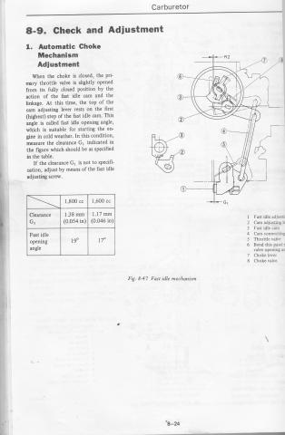

carburetor experts?
It will never run correctly until you get the fast idle screw adjusted properly. On the attached JPEG you want to try to adjust G1 into spec. What is your timing set at?

carburetor experts?
Sounds like you messed with the fast idle screw and you are correct, fooling with it is at least one of the biggest mistakes on a Hitachi (assuming it's a Hitachi). To adjust it back to spec according to the FSM you have to remove the carb and adjust the screw while measuring the clearance from the throttle valve to throttle bore. I scanned a page out of my FSM but I can't attach PDFs, so I will try to scan it in a different format this weekend. It's a pita. The clearance is like 1.38 mm. I have done it once and filed a piece of wire and measured it with a micrometer to make a wire gauge for the adjustment. Even then the adjustment wasn't terribly accurate but close enough. I agree with the other responses that it sounds like you have a vacuum leak. It might not be at the carb itself. If you have your charcoal canister hooked up, the valve on top of the canister could have easily failed or other things that your vac lines are hooked up to could be leaking. What's you timing set at?
