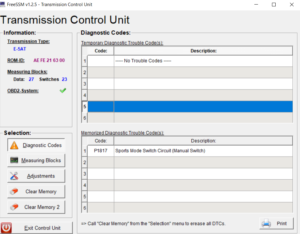

Thanks for the reply nipper. If it shows the previous cycle, then that is very odd because I haven’t had the sport shift mod error in at least 10 start/stop cycles and the most recent time the engine ran, I got the at temp light I parked the car immediately and haven’t been driving it since. If a fault code were to come up I would expect it to have been listed. -Could you elaborate more on what you think the problem is? -Also, how did you determine there is/was torque bind? I’m quite sure you identified torque bind on my 98 legacy about 10 years ago, but this car feels nothing like that- just pure slipping. Wheels and tires are all matching with very even tread wear . The car did come with another set of wheels that the previous owner said he took off right away, but that did have a difference of maybe 3/32 between front and rear. If any damage was done, I’d suspect it is possible from when those wheels and tires were in use.

Yeah, it seems to point at Body integrated unit (BIU) and then the gear shift selector. Both of which I believe don't seem related to the real slipping issue.

I still have to find the time to take the transmission pan off, but i was able to pull the TCU codes; No codes on the ECU, but the TCU had: P1817 - Sports Mode Switch Circuit (Manual Switch) I didn't mention this in the original post, as its only happened 2 or 3 times, where when if I put the car into manual mode and shift the transmission then try to revert back into "D", the car remains in manual shift mode. Also something that happens is the I, S, and S# engine tune knob is a little unresponsive occasionally; i imagine this the symptom causing this code. I don't suspect that is related to the trans slipping though. I found a cold thread that described the symptoms I am experiencing but they had codes P0700, and P1718 whereas I did not see any active or temporary diagnostic trouble codes on my TCU. Upon reading more, it seems like a fault transmission fluid pressure switch could also cause similar problems as I'm experiencing. Will post more another update once I pull the pan off.
